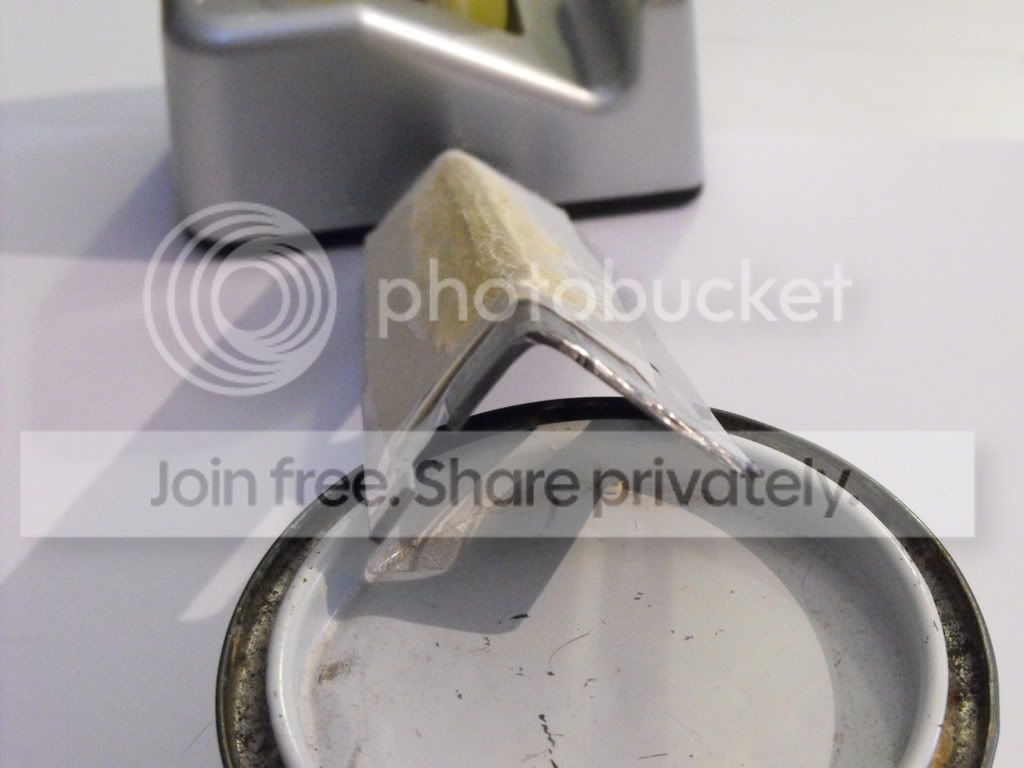

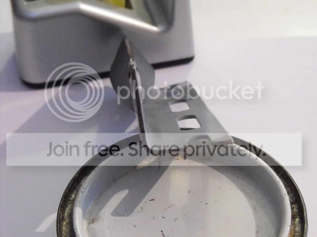

...3 (my preferred solution) building yourself a "felix7 sharpening-stropping station" (called tactically "Spigolo":D):
It is a "metal angled frame" that I cutted, to sharpening knives that have particular edge styles (Karambit, Spyderfly... concave edge/ "S" edges), on normal knives (straight-convex... Manix, Delica...) I use water stones Kai-Norton (120-300-1000-3000-4000-8000).
This sharpener works really well, it' s easy to use (but requires skill for free hand sharpening and trial & error, use cheap good knives to learn ), versatile and cost-effective.
I use these grits (european scale http://users.ameritech.net/knives/grits.htm ) :
-P120 for aggressive reprofiling-edge repair
-P320 for sharpening
-P1000 for polishing (less microserrations)
-Stropping on cardboard with car polishing creme
The sharpener works with edge out movements & the sand paper is lightly oiled.
The oiled sand-paper is extremely fast in removing steel from the edge (even the P1000 is fast for such grit), it works beautifully.
The edge at the end of the sharpening has a lightly microserreted edge (like DMT green little stone), but if you want an edge more polished you can use after "spigolo" a water stone (>3000 japanese scale) or Sharpmaker extrafine stones.
