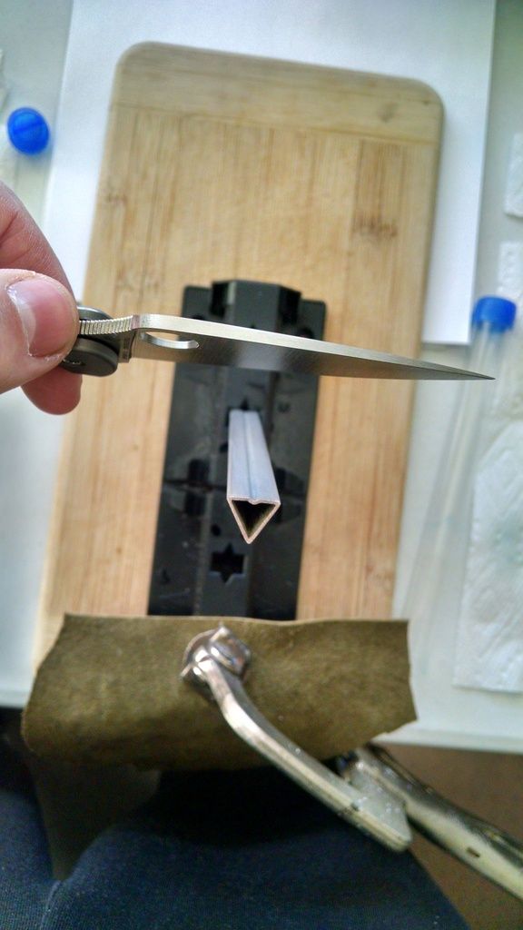

I use sharpmaker like this
This way i get same angle on both sides. There are no variations. I used a level to set the base the same as the spot in my kitchen where I mostly sharpen. It changes.
Here you can use both hands, with some finger pressure on blade itself for control, and can see whether you are going straight easier. Also easier to hold blade steady in one position. (in my opinion)
Main control is in the hand holding the handle.
Make sure you don't woble.
Go back and forth with most of pressure on the down part. Takes away more metal and saves time.
You gotta be able to cut pizzas in half easily to use this method.
Also SM is for enthusiasts who prefer secondary bevel touch ups
That's actually a great tip. I might have to try this. I don't have any issue using the Sharpmaker but this seems a little more accurate in terms of keeping an eye on blade angle.

Hey jalapeno, i fixed the image in my original post. I stumbled upon this method after i bought a single UF rod from my local knife store. They didn't sell them in pairs and i wanted to save money. I kept turning the base around until i just oriented it that way and kept changing the hand after that. I now sharpen free hand, but i got very proficient with that SM.
