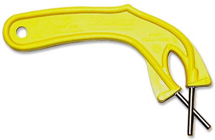

I think my problem is I envision it working something like one of these systems where the rods intersect and create a fool-proof angle that you just run your blade through until its sharp.

Problem is that the V looks too big
OK, I think I understand what you are saying. In you yellow v sharpener (not the Spyderco) above, you sharpen both sides at once by putting the edge in the vertex of the angle of the rods.
On the sharpmaker you only sharpen one side at a time, and you are only concerned with the angle of a single edge against one rod, at a time. In this case since you're only doing on side at a time, the separation between the stones of the Spyderco are irellevant, they could be 2 inches or 10 feet.
It's not much different from using a benchstone to sharpen, that is one edge at a time.
