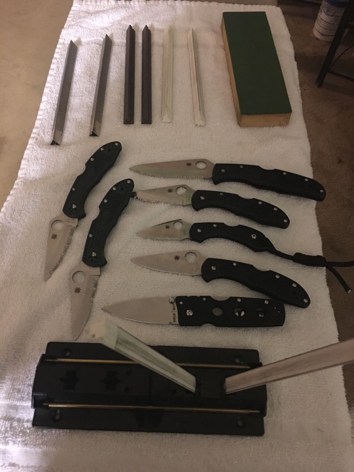

weekly touch up time
When they get loaded, use Barkeeper's Friend powder to remove the metal particles. It's about $2 for a large can at Walmart.

I agree 100% ;) "Bar Keeper's Friend" cleanser that you can buy at many grocery store chains, hardware stores and even those Dollar type stores even have BKF at a decent price is by far the best cleanser I've ever used to clean my 204 stones and other Spyderco stones as well. My local discount store has the big cans of BKF for less than $2. It's without a doubt the very best cleaning compound I've ever used on Spyderco ceramic stones and it's one great rust remover as well.
After I clean any of my Spyderco sharpening stones with BKF they look as though they are new from the factory.
The 204 Sharpmaker is an excellent tool to sharpen blades for the novice the seasoned Pro alike. However there is one recommendation I make to everyone who buys a Sharpmaker. In order to have a complete kit you absolutely need to buy the diamond rods and the ultra-fine stones you can by extra for the kit. I've yet to try the CBN stones but they are on my list to get and I'll be getting a set shortly.
But the Sharpmaker in my humble opinion is not complete without those two extra sets of 204 stones/rods for the kit. Because without those ultra-fine rods my blades would be a lot less sharp than they are now. And the diamond rods are a real help if you have a beat up or dinged up blade. They do a more rapid stock removal which is a time saver to say the least. But definitely get the extra stones.
