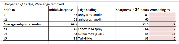

Vadim, have you ever experimented with the effect of lubricant on the BESS score? For example comparing a clean dry blade to one coated with oil or even just water?
Hi Todd,
I tested some, when looking for a lubricant to seal sharpened edge before sending it to the customers who also have the BESS sharpness tester.
As seen from this table, the Anhydrous Lanolin showed the best and I used it in the experiments in the video
