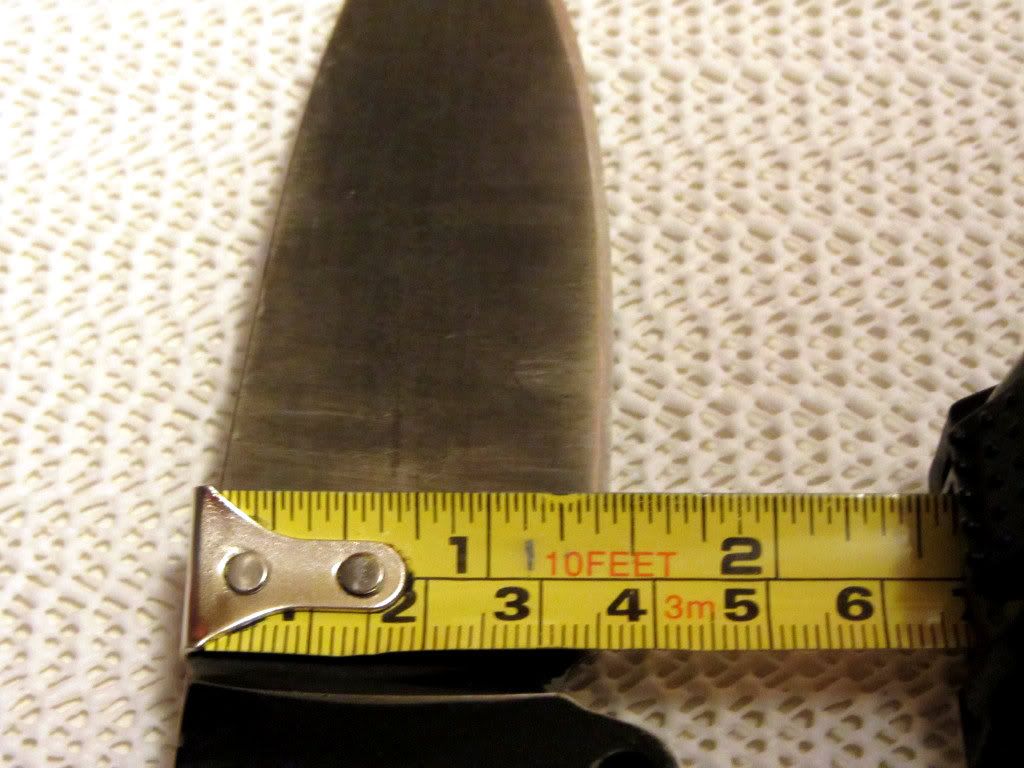

- 1.5" wide

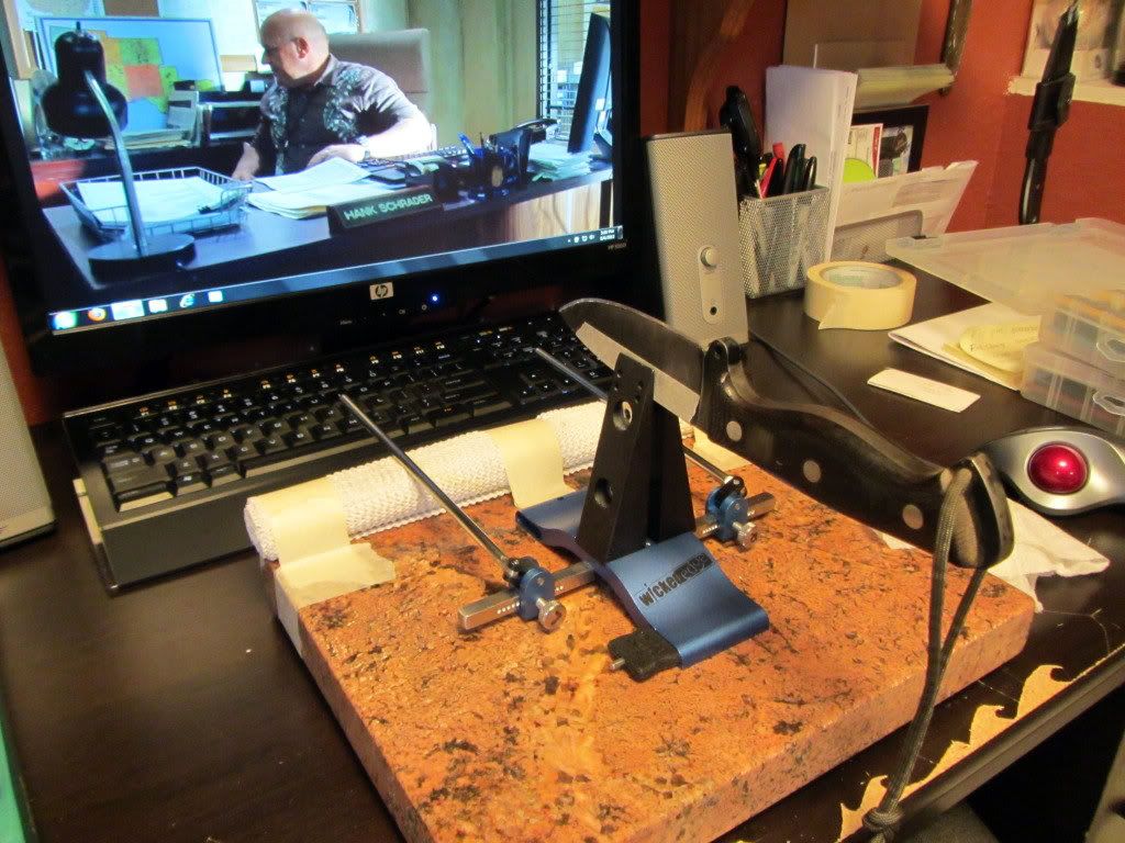

First thing I did when I received the knife was put a "wicked" edge on it!
For those of you wondering, that is "Breaking Bad" on the screen.
Sharpened with 100, 200, 400, 600, 800 and 1000 grit stones. Edge was left hair popping sharp for the latter testing.

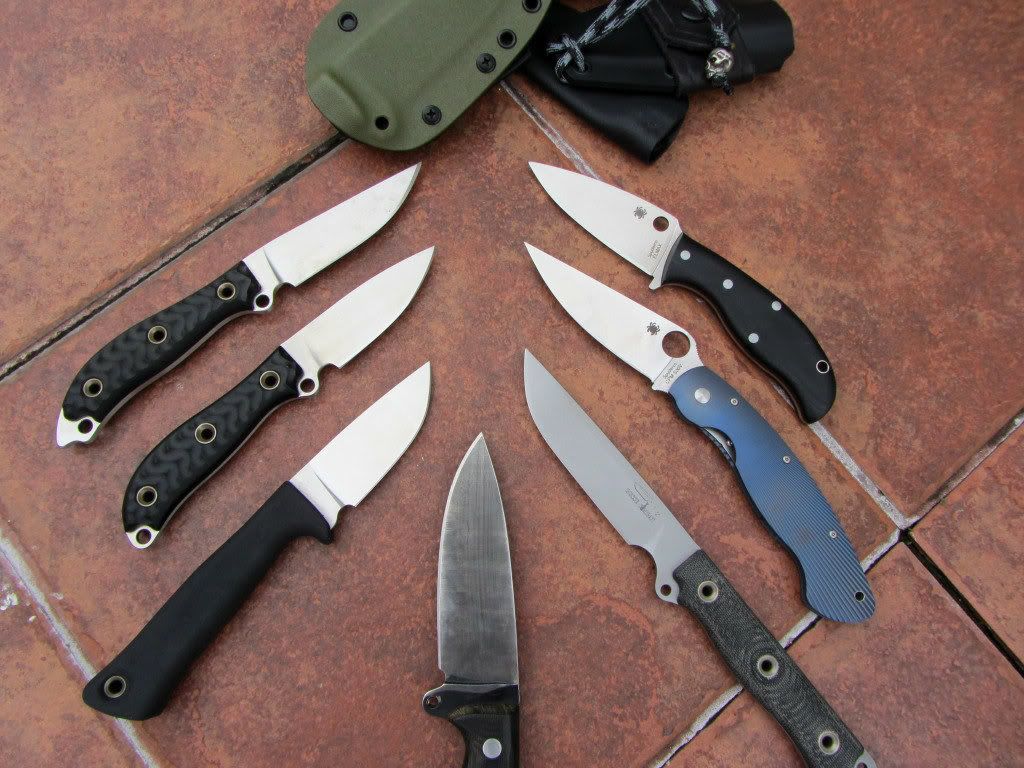

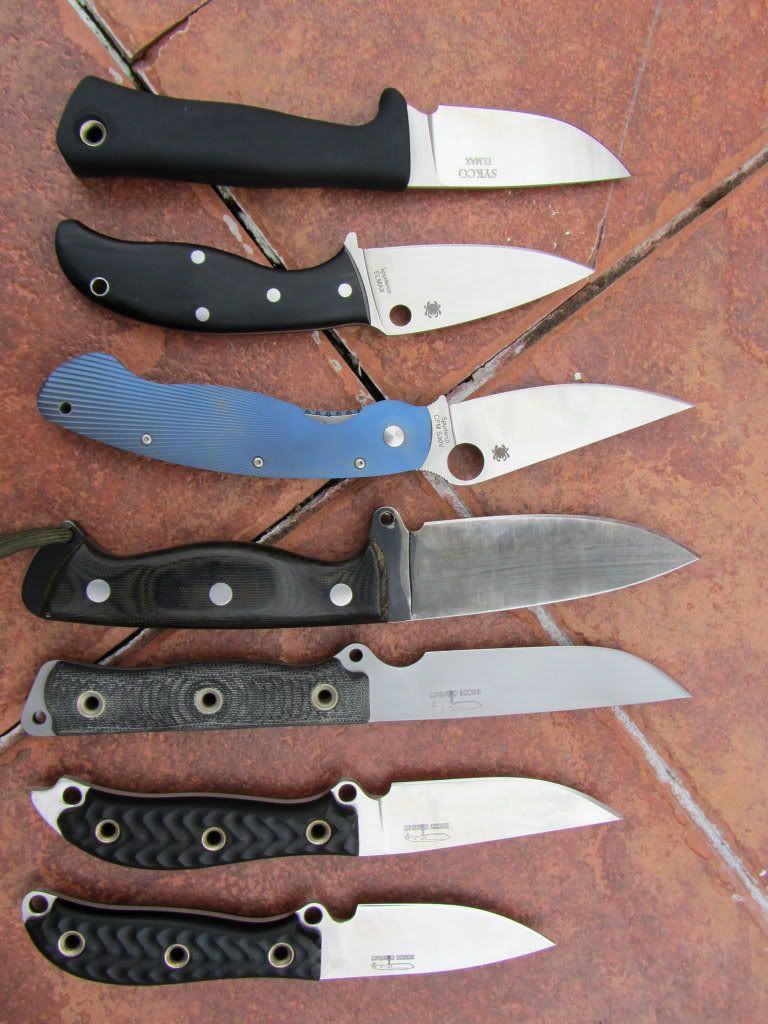

The knife that most comparisons were done with:
My trusty tweener meaner, also with a shaving sharp "wicked" edge.

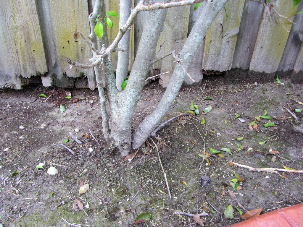

Second test: I was removing some ferns from my yard when the thought that using the SHBM to take one out would be a great test for it.
It cut through those roots with ease.

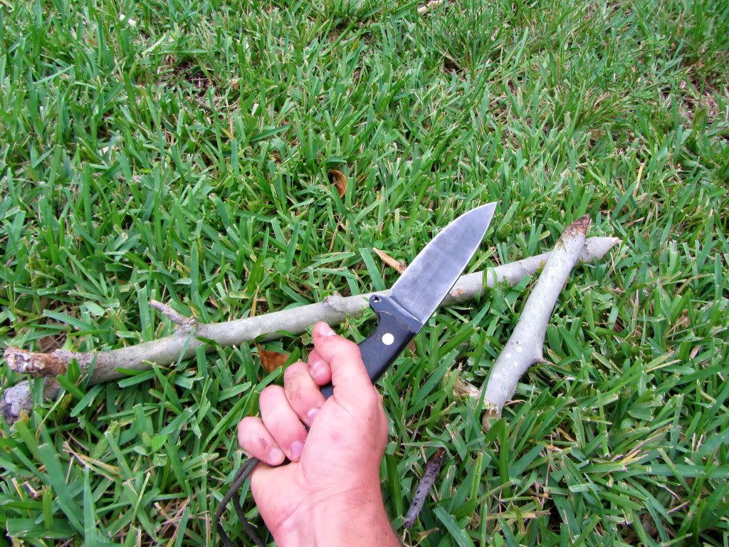

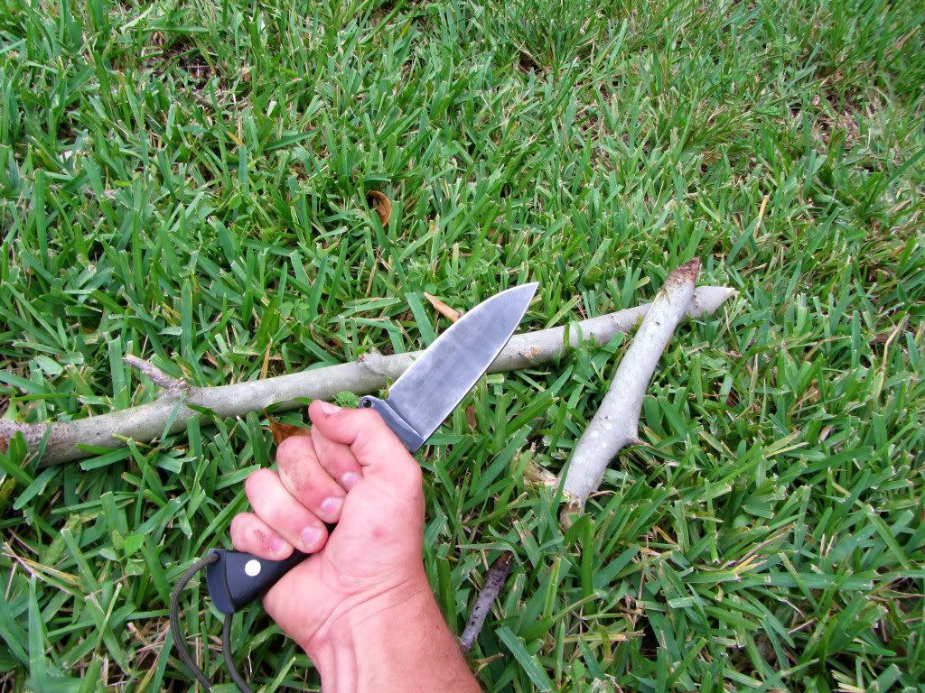

No problem here, the weight behind the knife makes chopping through these limbs a breeze. I didnt bother trying it with the meaner, its just not heavy enough.
The ergonomics are by far my favorite aspect of this knife.
This grip here is great for chopping, gives a solid grip with better swinging action to bite down deep.
The bigger knife just feels way better in my hands, fills the palm up nicely. Next I wanted to make something sharp.
Here both knives excelled with advantages of their own. The SHBA worked its way to the center faster while the meaner was able to give more precise shaving for a very fine point. Both of these knives obviously would serve different purposes but its the closest bussekin I own to the SHBA range.

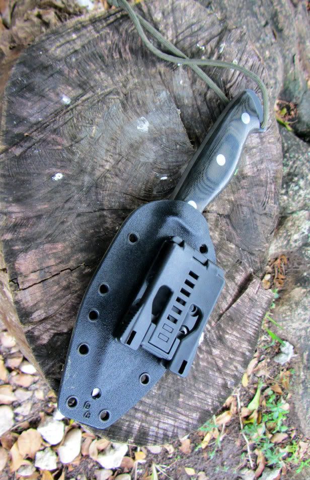

Please understand that I am giving my honest opinion and will not sugar cote or hold anything back in my review. That being said, David Browns kydex sheath is the best kydex sheath I personally have ever handled. Not a single sharp edge, no rattle whatsoever, beautiful mold, perfect retention and my favorite: one finger disengagement. A lot of kydex sheaths out there dont seem to get the release right, it is either very hard to take the knife out or the retention sucks. David got both spot on!
The following pictures were taken one right after the other to show how easy it is to release the knife. Please note that I am righty and it was just as easy for me to release the knife with my left while snapping the pic with my right.
Awesome!

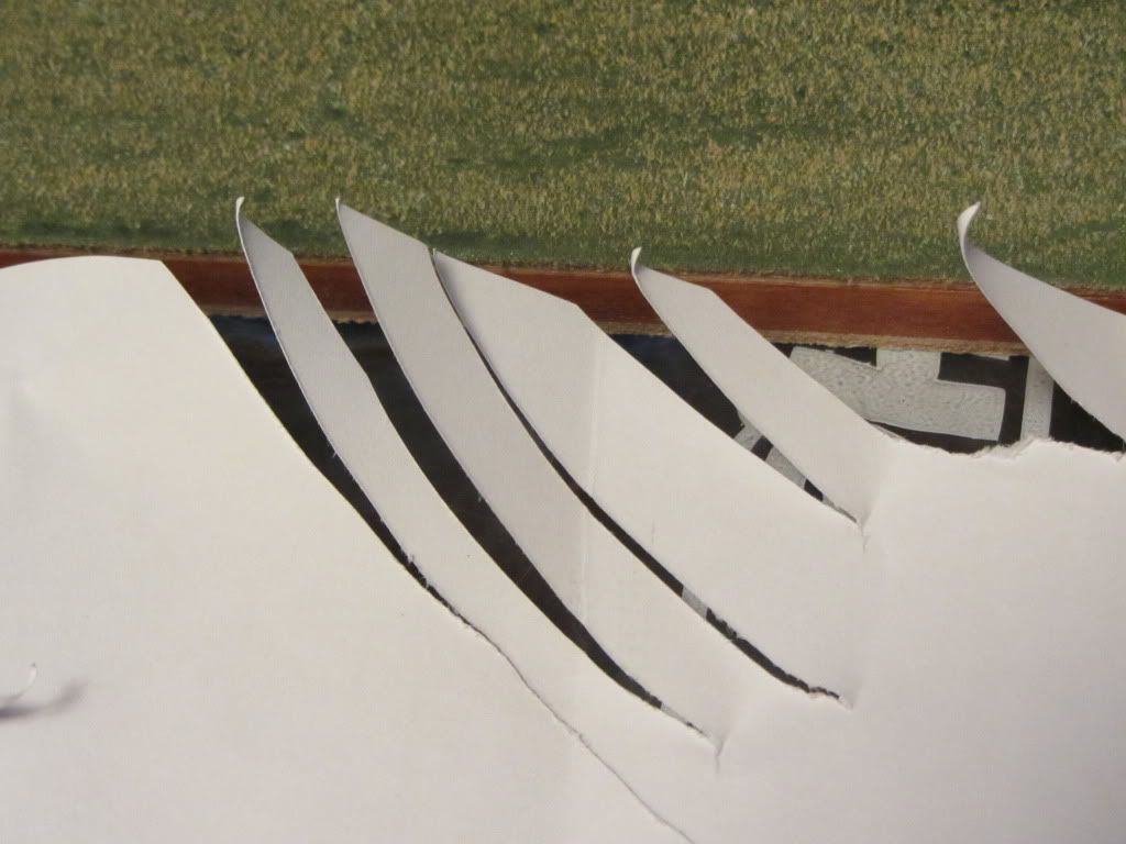

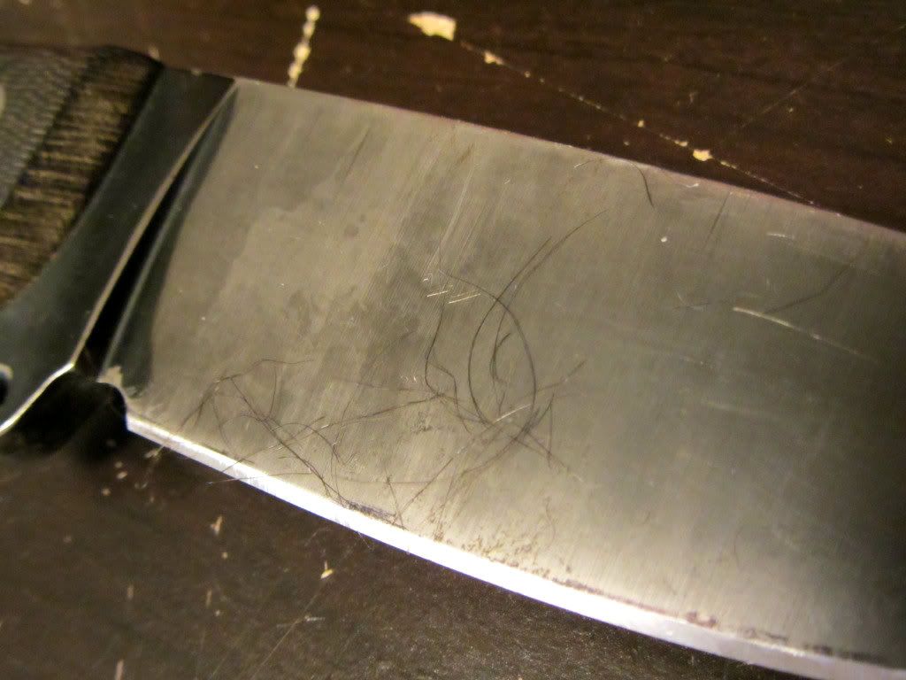

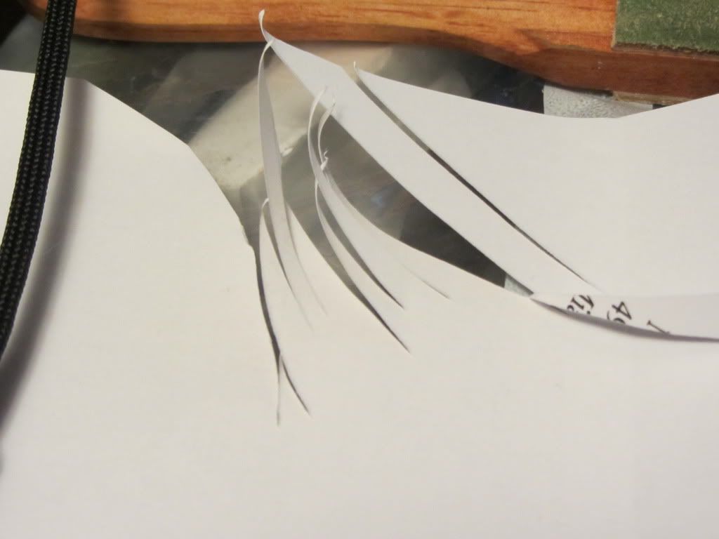

After all the chopping the SHBA was no longer shaving but still slicing through printer paper. The slices were a bit sketchy but after a couple of swipes on the strop it was slicing through it with ease.

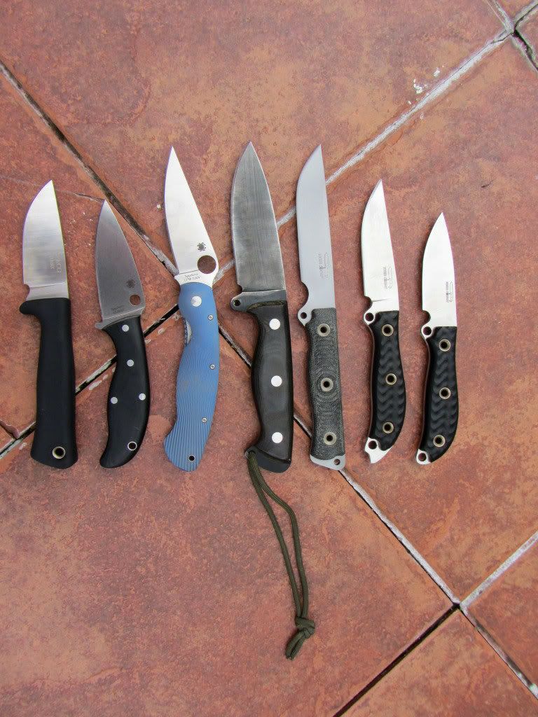

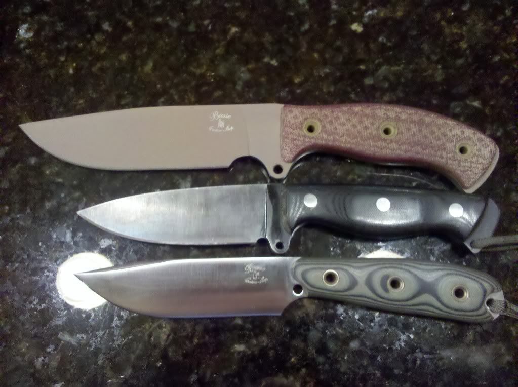

Spine shots of the fatty next to a BAD.

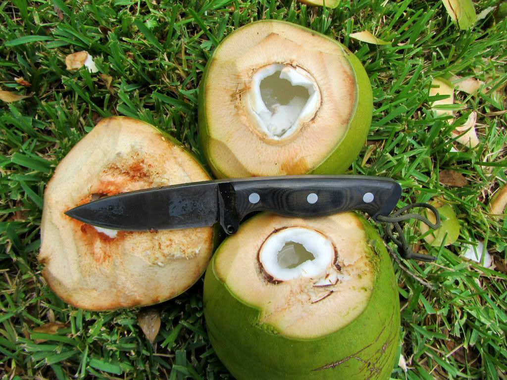

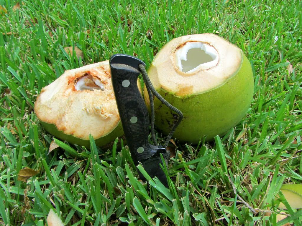

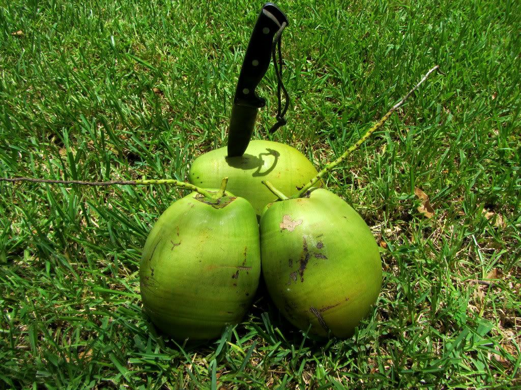

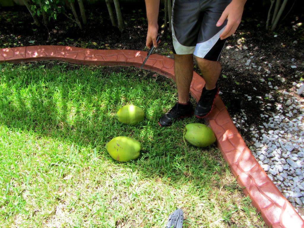

Who likes coconuts? Badger does!
Normally I would do this with a machete but the SHBA cut through the tough husk with ease. Splitting them in half was a little harder since you dont get a lot of leverage with the smaller blade but it still only took about 5 or 6 whacks for each coconut. The main reason I chose coconut was because I have found it to be harsh on edges and I wanted to see how the A2 would hold up.

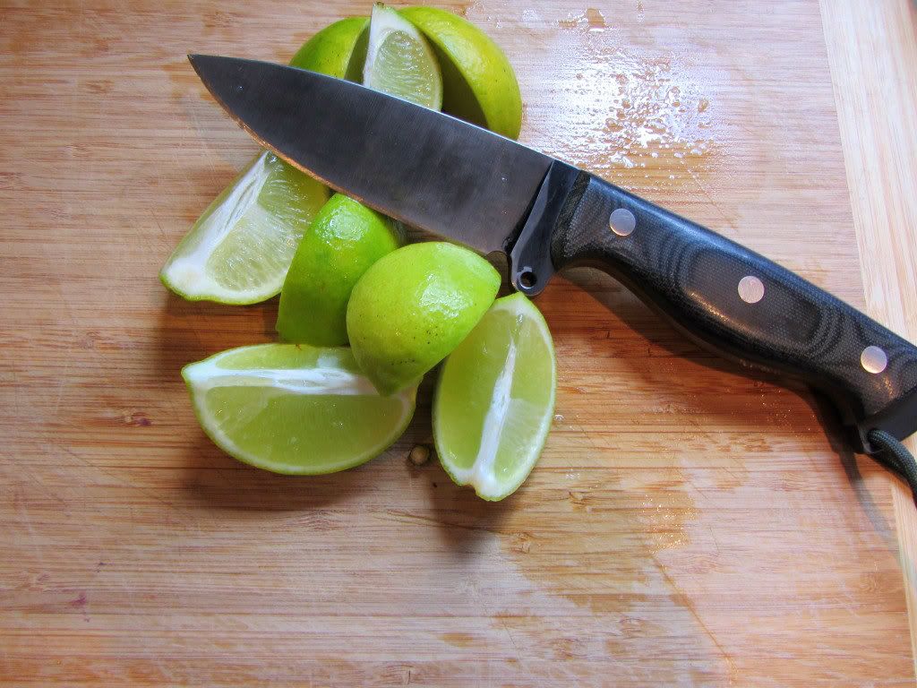

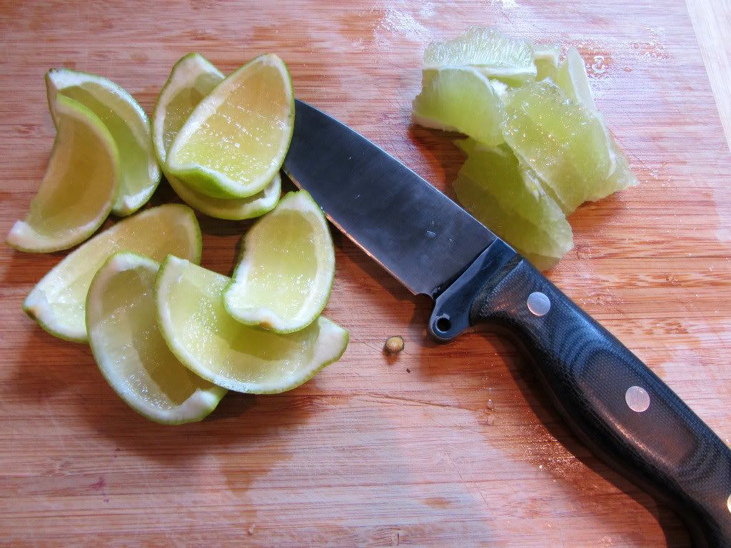

Cutting up some limes? Easy!
Removing the inside for a limeade? Not so much!

Yea it's fairly easy just make sure you go through the back of the coconut. If you try to go through the top it takes longer and the shell is usually very thick and hard up there.

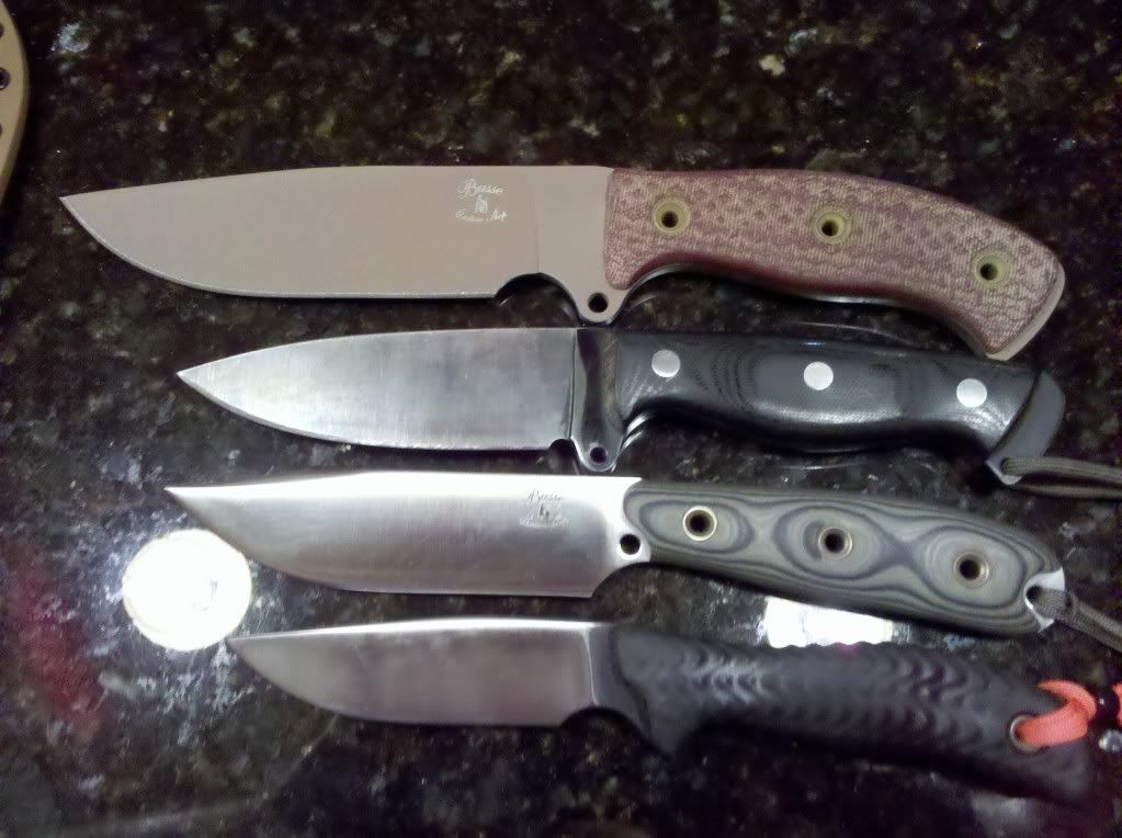

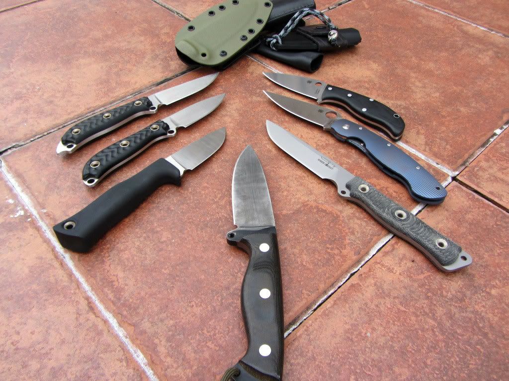

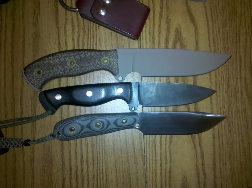

Its been raining all day but I did drag several out to my in-laws' and got a few pics. I haven't had a chance to use it yet so this is like first impressions and comparison pics. The handle is very comfortable, handle heavy, mic'd .29 and I love the blade shape and grind. It reminds me of my leaf shaped spydercos I love so much. I had it on my belt for several hours and it carried easy and never poked me. I was glad to see its already well used. I was kinda nervous about using it but I definitely wont have anything for it that it hasn't seen before. There is some slight deformation on the spine that looks strong but plastic and made me wonder if these are differentially heat treated but I couldn't find an obvious hamon.
DB's sheath is a perfect fit, no surprise since I already have at least 20 of his sheaths for everything from scrapivores to AKs. This is the first 2 tone I've seen and its pretty cool.
a few pics so far
