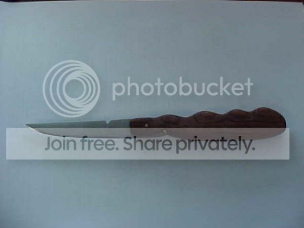

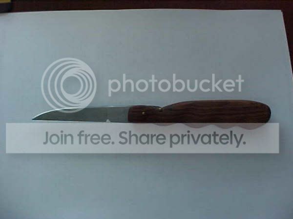

These are pics of my 1st knife a friction/flipper folder. Its 8in.overall with Honduran rosewood (i wish you could see the grain its gorgeous ! )and 1084 with 3/32 brass pin/pivot.
I started the edge grind 3/4 of an inch from the front of the handle so if it closes while using, it wont cut ya. Its a flat grind and swedged
It fits my hand puurrrfectly. Locks open when flipped ( not really locks but u dont have to hold it open,it stays till you apply pressure to close it)
Ive been carrying , using an SHOWING IT OFF like a brand new baby
and have gotten nuthin but positive comments and requests for them.
Im building 2 more now for my brothers and my wife has one that she even asked for !. It still needs H/T and the pin finished but that hasnt stopped my from using. I LOVE IT !
Comments plz
