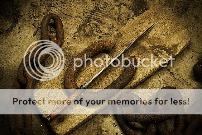

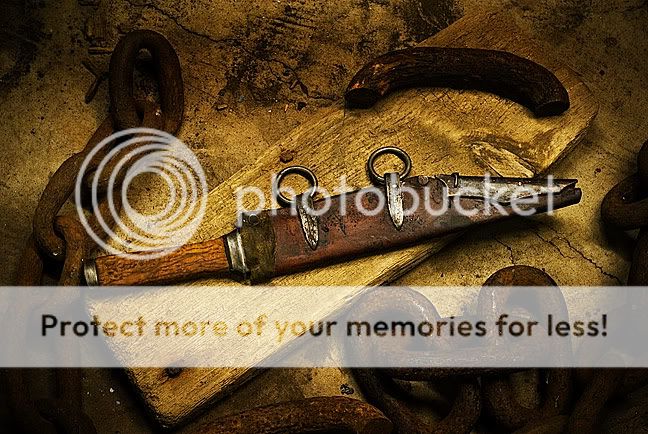

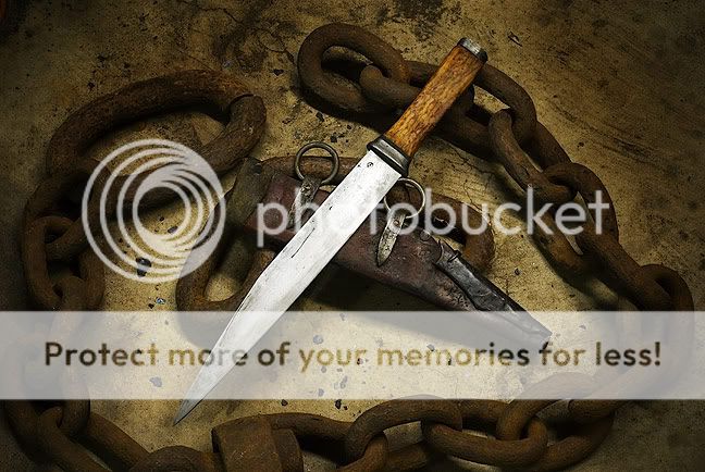

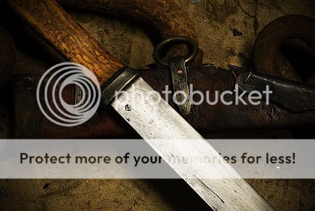

It's DUN. Forged from home-brewed shear steel, 14" blade, 19 1/4" over all, Masur birch burl handle.. slightly swept back, anchor chain wrought iron fittings... etched in ferric chloride/copper solution... then liver of sulphur. leather spacer. Scabbard with anchor chain wrought straps, cold forged copper stained with sulphur, copper rivets and brain tanned doeskin liner for a nice comfy, scratch free fit.
It is lovely to hold.. and just feels absolutely deadly. I'm excited by this sort of design and am looking forward to exploring the possibilities for some modern fighter designs.
