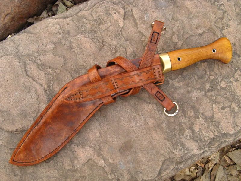

He's the one that made this one for me:
Which, if I have my belt through the loop on the back of the sheath, really is a quick draw. I can flip open the retaining strap and draw the kukri quite fast. Can't put it back IN fast, but it's a quick draw, not a quick sheath.
