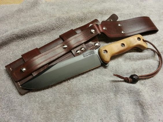

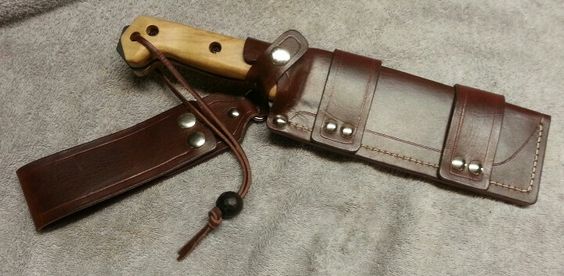

I did this one for a customer which is multi-carry but I tried it out and liked the drop leg... the thumb strap has two snaps. Truly ambidextrous. He made the scales and had a lot of input. Was a partial copy of a smaller version I did for a camp knife. All in all, it rode well on a pack, belt, drop leg...

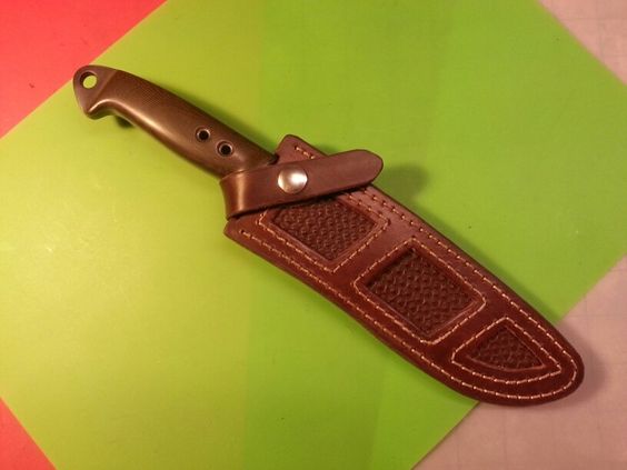

Or my personal answer to the BK-7, a 7.25" bladed 1075 steel chopper with olive micarta on white liners. This one has the belt strap right below the top on the back. Sits high, and can be covered with a shirt tail. Thought I had a better pic.... Cell phone shot, its actually a lighter tan inlay with dark brown surrounding.
This was as comfortable as I've ever carried a big knife. It depends in his size too. I'm 6'1" 225# and can conceal a full size 1911 fairly easily. For those with less mass, it just takes some creative thinking...
