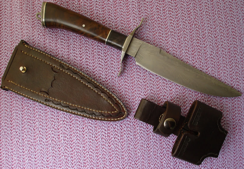

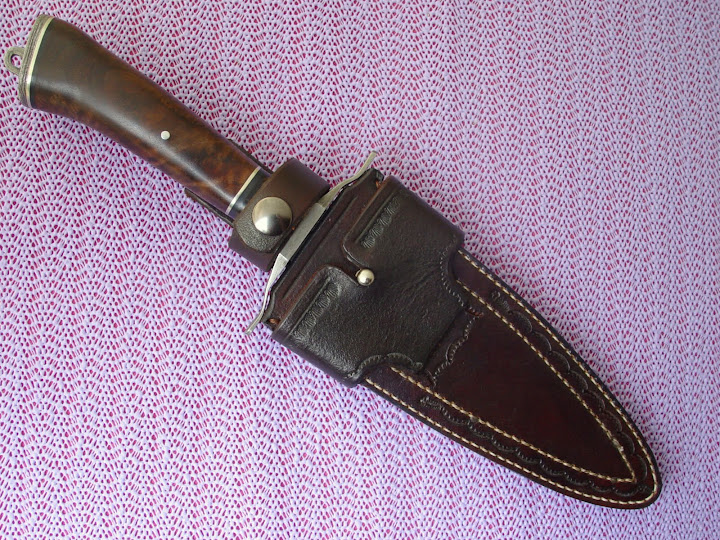

The collector that ordered this knife wanted to be able to take the belt loop off and slim the sheath down so it could be carried in an inside pocket.
The false edge is extremely sharp and needed a pvc insert sewed into the sheath so as not to cut the stitching.
I can finally get this delivered. Yea! Fred
