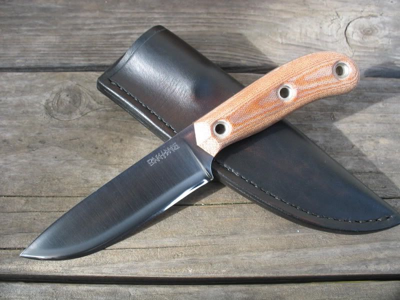

well here is some pics of my finished sheath, for my BT4.5... i kind of rushed on it, so i could have had it done in time to take it to the shop last night, but i didn't end up going..

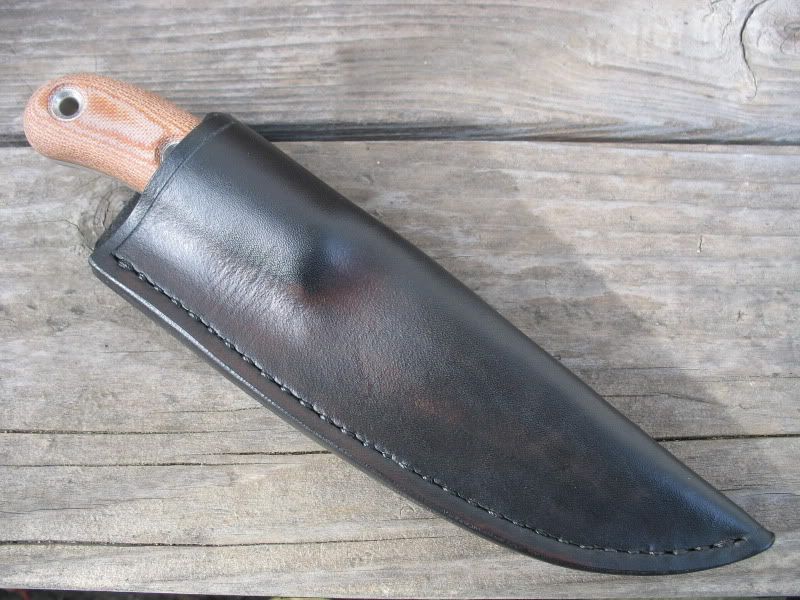

it came out okay.. it fits the knife good.. it's in there nice and snug..:) it's 8-9 0z. veg. tanned leather wet formed, dyed black(with few blems :() and then finished in beeswax...

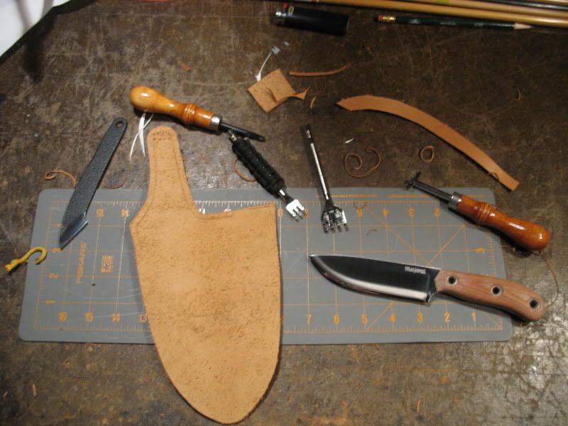

pattern all cut out..

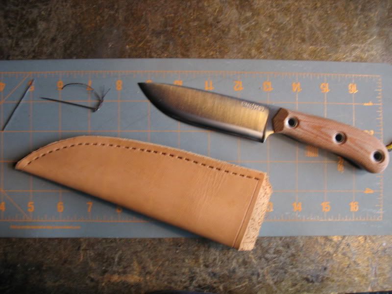

all glued up, holes are punched and ready to be stitched..

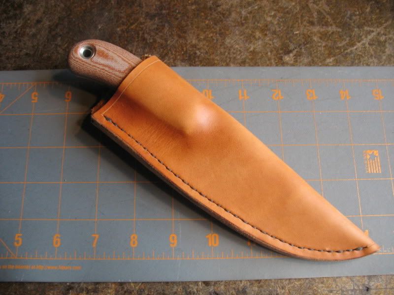

wet-formed.

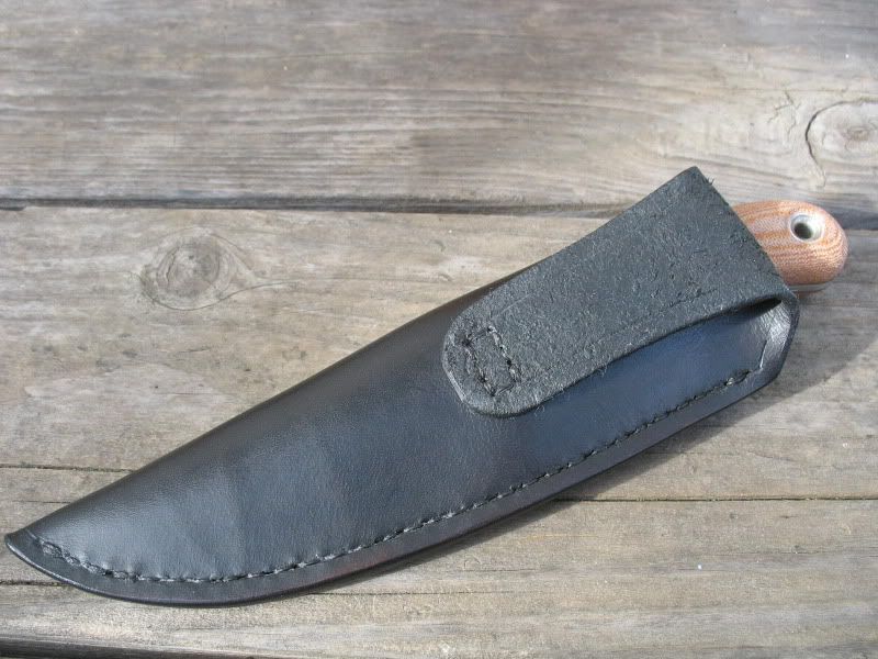

and the finished product...
i am loving this knife...

Forgive me as I am new to the beeswax finish, but how did you finish it with beeswax? Do you just rub it in or do you melt it like parafin wax and dip it?
no worries... i do both, but on this one, i melted the wax and rubbed it in..:)
Does that make the leather more "stiff" or solid?
I believe that also makes it more resistant to water, right?
