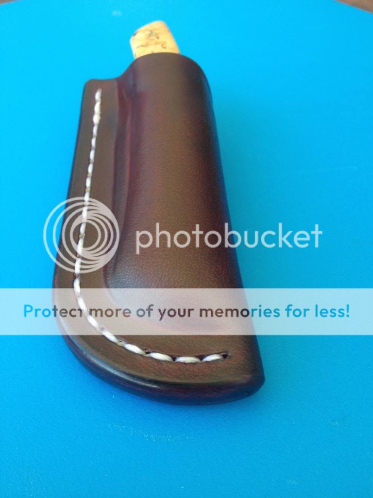

This is my first sheath for this knife , I plan to make a Horizontal one next .
Ken
Nice and clean! I really like how you did the stitching on the belt loop.
Thanks ,
I agree I also like the lines of the stitching on the belt loop , but it is there for a reason .
On these sheaths I skive the belt loop piece onto the main sheath but turned over so that when the loop folds you dont have the rough side of the leather visible on the outside .
The skived join is glued and is held on the welt side by the stitching , but on the front i feel its necessary to stitch the join . On my first one of these sheaths I only stitched the join and it looked horrible . So now I continue the line of stitching on and then attach the loop with it .

Gary, can you photograph the loop more? I'm not really understanding how it was formed. Is it one piece folded over and stitched, or two pieces glued and stitched together? Is the interior lined?

The belt loop has a piece of leather glued onto the main part of the sheath - loop to make it double sided . That piece is skived so that it tapers and disappears into the welt . The opening of the sheath has a rolled edge and the the sheath is not lined .
The line of stitching that runs along the edge of the loop and attaches the loop to the back of the sheath is mainly aesthetic , the glued pieces will not come apart anytime soon , but I suppose the stitching does add some strength .
I just like the line and effect that it gives .

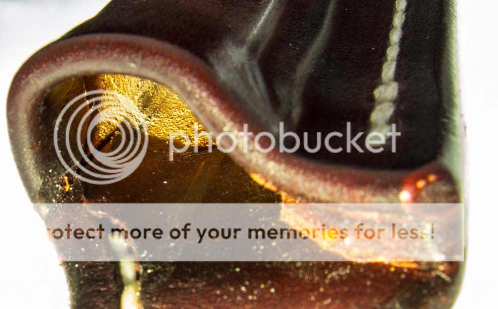

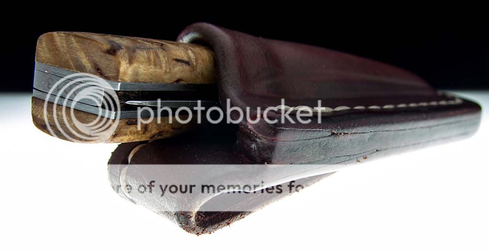

Here are some images and please take note, this was Ken's first attempt at this new design of his, although I find nothing to warrant any worry, as it looks and handles great!
Ken_Sheath_spine.jpg~original
Ken_sheath_Compagnon.jpg~original

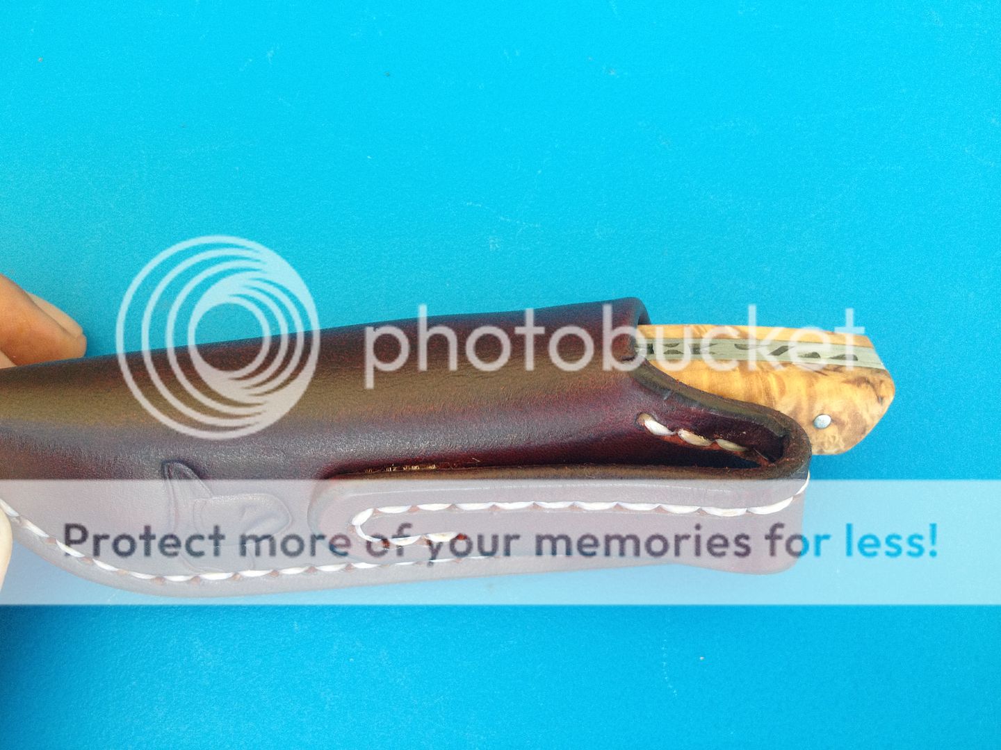

on this view you can see where he has tucked in the thinned out 'good' side of the leather down into the welt.

Inside the sheath you can see where that skived area also is glued down and ends

a closeup of the belt loop, you can see where the skived leather stops and was trimmed down so the belt loop wouldn't be too thick, nicely done too.

Ken, I admire that work far more now having seen it close up. I still need to figure some of it out (like what exactly is done at the top of the welt) but your work shows obvious care. I don't use white thread myself, but you put it to great use. Bravo!

That type of sheath took a whole bunch of working out and was a real mind bender to plan and design the first time .
I have simplified a few areas now that I've made a few .
There are little things that aren't obvious that add to the complexity , for example the opening being sloped and angled creates issues when you incorporate it with a rolled edge . Also Gary has mentioned it by calling it a " one rugged sheath " but even on a folder sheath I use quite thick leather . I like the solidness that it creates in the finished sheath even though it adds to the headaches when trying to work with it . Most of my sheaths are given away to friends , and most of my friends are rural , outside , in the dirt type of people , so my sheaths have to be solid and tough .
