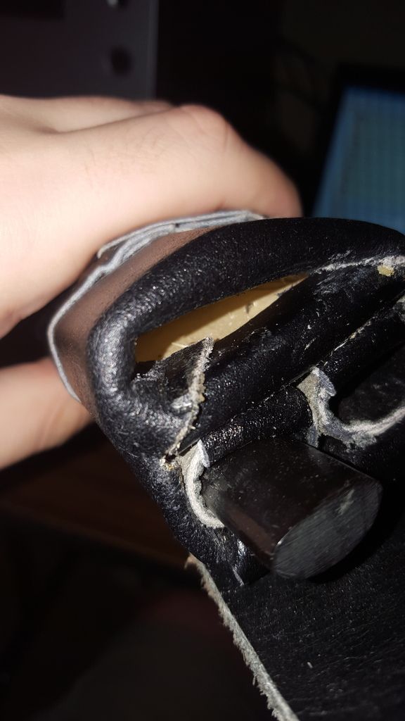

I just got a small kukri I believe it is a BSI or MKV. one thing I noticed is the kuk draws very hard from the sheath, is there any way to make the knife looser and easier to remove. It is so tight you have to force it out thanks

If the sheath is too tight, what you have to do is peel some of the leather away from the wooden core, probably on the part that sits closer to the body, and shave down the wood to make it less tight. Then once you're done you can use plain old glue to reglue the leather to the core.

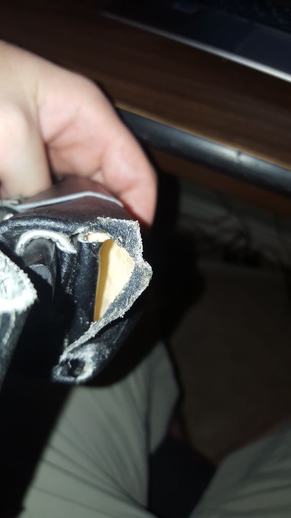

My mistake, I did it peeling up the leather on the outer part, not the inside. It's easy enough to peel it up, there's usually a part where it is folder over. I slipped a wire coat hanger in and pulled it up with that. As for shaving down the wood, I used the karda to do it, but any small knife would work fine. Then once you're done you can push the leather back in pretty easily. I'll see about taking pictures to show you what it looks like. It really isn't hard. I'm not handy, but I managed it fine.
The diagonal line where the leather folds over is where I peeled it to get at the wood. The second picture shows what it looks like with the leather up. I still haven't gotten around to gluing mine back down.

Do the same thing I did here but instead of adding material shave the wood underneath the leather. Usually the binding occurs only at the throat of the scabbard and is usually only at the spine at widest part. When the Sarkis cut the wood they make sure the blade fits properly and it usually does. When they add the leather it might end up tighter than desirable. You will likely only need to shave the first inch or less. If its minor you can shave the inside of the leather and it will be fine. Look for a shiny spot on the leather where the blade packs the leather down and thats likely the spot of interest.

hi, I got the sanding done, I opened the throat I then noticed that I had to force the knife int the sheath.The bind was way inside I thing beyond the curve so I glued some sandpaper to a shade stick and sanded the area toward the point. That worked. Thanks for the advice Mike
