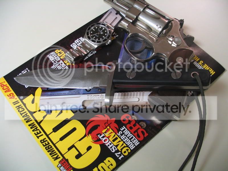

i just finished my first real knife. it is a copy of a knife that was designed for the mercury "astro"nauts. it is 01 tool steel with black linen micarta with bolt on handles and a milled out space for survival items. would it be in bad taste to see if the original knife maker would make a leather sheath with the sharpening stone pocket? i just wouldn't want to offend them, but would like a nice sheath for it. thanks

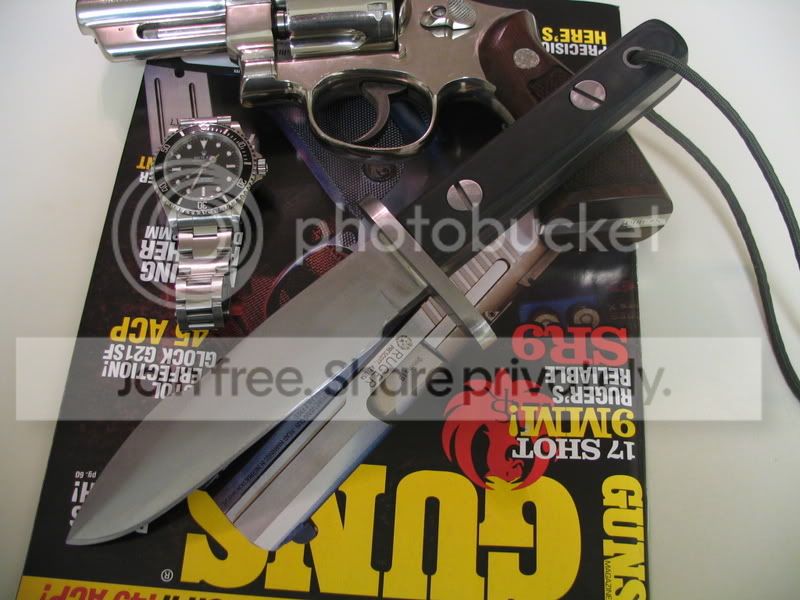

here are some pics

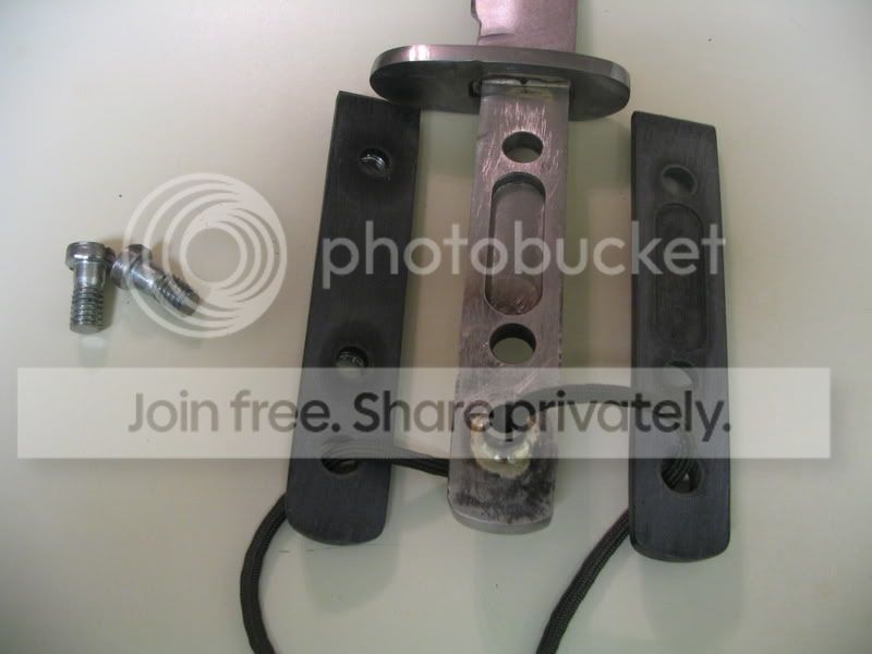

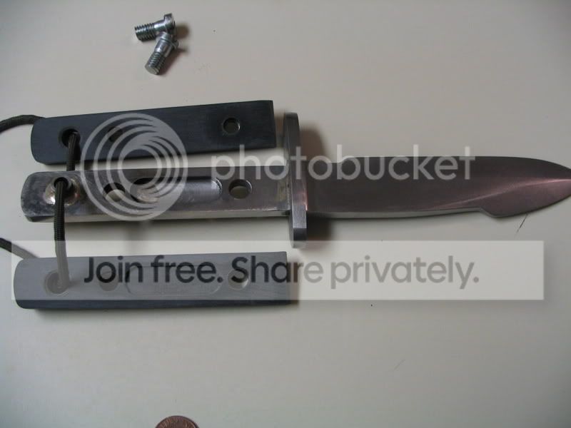

i learned a lot of skills on this one. using the lathe to turn down the bolts into screws, turning the lanyard tube to size. milling the guard slot. silver brazing the guard, and lanyard tool. playing with the new kmg clone, and the 2x42 crafstman...
Very nice! I, too am working on my first and it is a simple design comparitively. How easily do the bolts unscrew? Maybe a keychain type screwdriver on the lanyard for a more functional surviaval knife?
Nice Work & good photos
You know i always wondered - how useful was the pocket inside the handle if you needed a screwdriver to get to it ?
(oh - and nice watch - i have been wanting one of those for years- something else always seems to get in the way )
