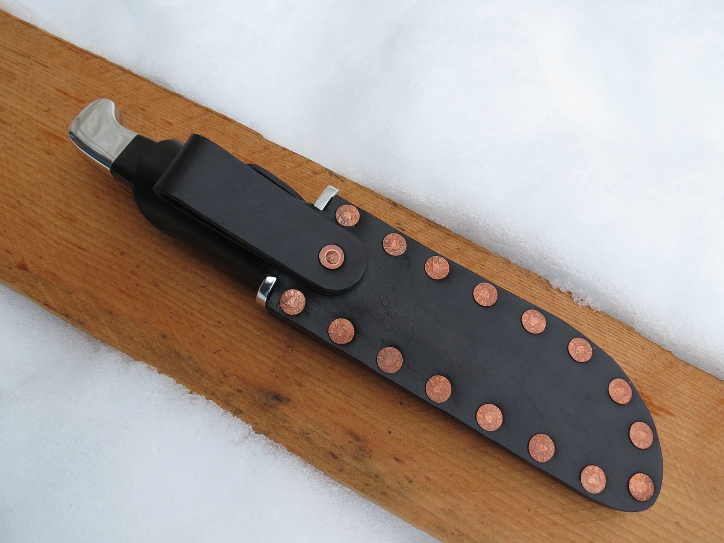

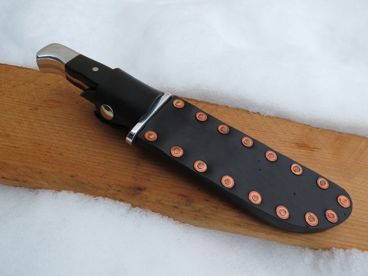

I'm a leatherworker, and I love using copper harness rivets for almost anything I'm not stitching. The ones I use are #9 copper rivets and burrs, Tandy brand.
I've never been a fan of the type of rivets in the OP... They're just not very durable in my experience. Personally, if that were my sheath, I'd pop all of those rivets out and replace them completely with harness rivets.
Here's my 124 sheath built with the copper harness rivets.
