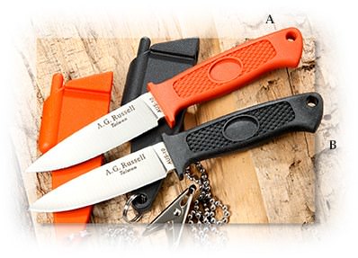

Some years back AG Russell sold a line of plastic sheathed knives...Deer hunter, trout and bird, hunter's scalpel, that all used the same retention method. The front of the plastic handle was shaped into a finger guard that fit into a rectangular hole in the edge side of the sheath, There was a spring loaded post on the other side of the sheath. To remove the knife from the sheath you pushed the post with your thumb and the knife would tip a little in the sheath and come out. There are lots of pics out there on the net of the knives and sheaths. I had a couple of these knives and the retention was very good. The spring loaded post might be a challenge to fabricate but this might inspire some other ideas
Thanks Mahoney. That's one I hadn't heard of. Some Googling revealed that AG Russell still makes that knife/sheath package. It's called the "Thumbolt" sheath (patented, of course) and they claim it's the "saftest in the world." It was actually designed by Blackie Collins. Seems he had a thing for sheath retention tricks!
