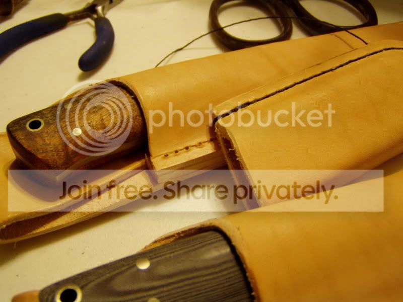

So I'm knocking out some quick and tough sheaths, and while I'm at it I made a little pouch for a pistol magazine. To keep the top leather together, I carried the top stitch into a wrap over the top and around to the back twice...and I kinda like the look! That got me to thinking that it might work to keep the top of the welt and such tied down on the knife sheaths...
...so before I punch/drill another hole and potentially ruin a nearly finished sheath, I thought I'd bounce it off y'all. It doesn't hurt that I slipped and have a light gouge that this extra lop would conceal nicely either.:(
Is it a stupid idea to carry the top stitch over the top of the welt to tie it down or will it look totally stupid? I just can't picture it...
I have done it in earlier sheaths I've made, and they've had no problems with use (some keepers I made as I was learning early on). However, the downfall is that it exposes the thread to potential damage/cutting; whereas, normally the vast majority of the thread is protected in the stitch groove.

I won't say it's stupid, but it is impractical and the eye is imediately drawn to it in a bad way. Just my opinion.
Exactly why the pros don't do it plus it looks "amateurish".........

Be my quest, but repair a few hundred sheaths sewn like that as I have and you'll learn why it's best not done........dealing with upset customers is a hassle and turns away business.......
Yes all leathercrafter's have a great deal to thank Al Sohlman for, but he wasn't god and in this case he was wrong.......besides styles change and today's aesthetics are not the same and I try my best to keep up with the current market within reason.........

Like I said, I have done that type of sheath in the past, but I like the clean look (IMO) and the thread protection of not looping over the top stitch.

I hadn't thought about how easy it would be to cut it while inserting the knife...dang good point. I was focused on my previous units all having the welt and top layer coming loose and showing the gap after a little use. That wouldn't be a problem on my mag pouch though, so I'll leave it alone.:D

Dead on, this trade is open for artistic expression but the idea is to make a product that will stand the test of time. Some things are just impractical. I have found that the average customer wants a custom knife and sheath because they understand quality and they want the best they can afford. There are standard ways of doing things because they have been tested and they work. The market knows this and recognizes what works and what does'nt.

Yes a few hundred repairs (few of those repairs were my own because I quit doing that stitch a long time ago) since I started this doing leather crafting back in 1961 - I spent a good part of my learning experience working with several old timers and much of my work in the beginning was doing repair work. Later in the first of my own shops repair work of everything from knife sheaths to harness to saddles was a large percentage of my day to day work - IMO doing repair work is one of the best ways to learn what works best and what doesn't. It's not just a matter of cutting the thread, but the thread may/will also wear faster due to it being exposed, so IMO why do it?
