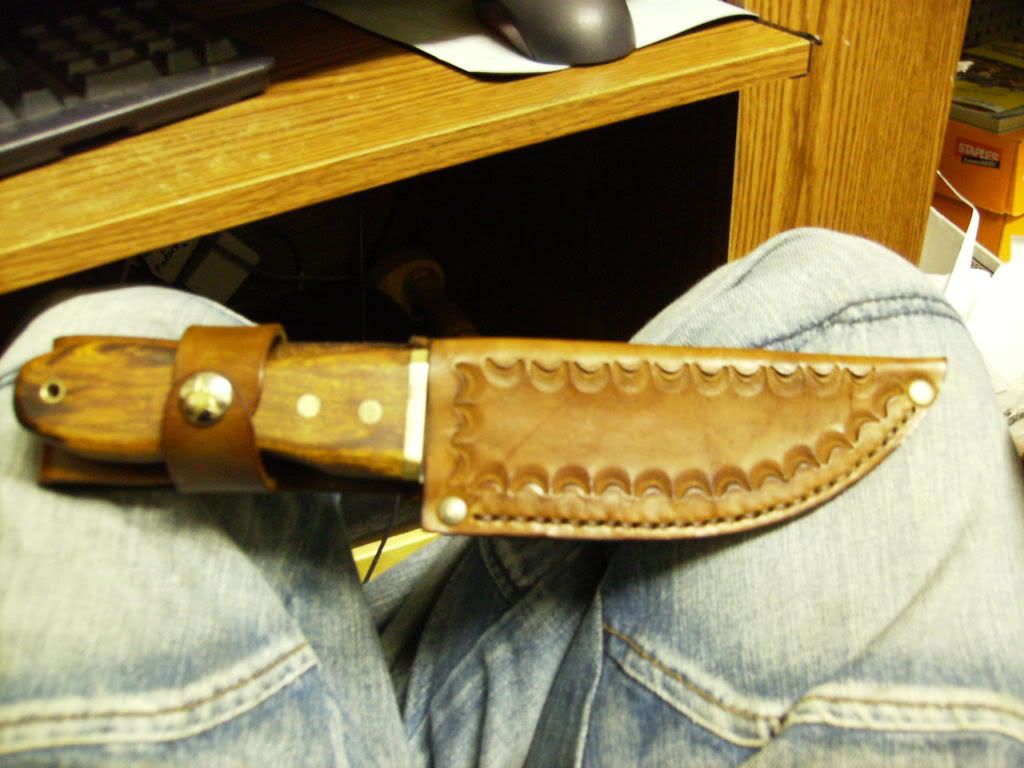

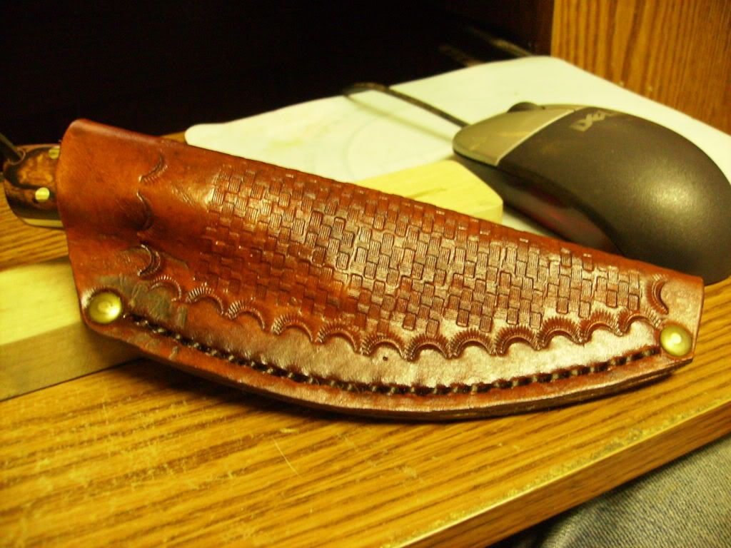

STEPHAN thanks for the link i need alternate source tandy s high quality isnt very good and expensive . I am looking into shipping right now to canada. It may not be feasable. thanks anyway. What i do with my tandy leather is soak in warm not hot water for 5 min at least and use a small sponge paint brush. The Dabbers are ok but not as good as the sponge you can also just dilute the dye with some water but still soak the leather first. This evens out the dye. Im using feilbings as well . kellyw
I forgot to mention you have to towel dry the leather, and then your good to go. here are some i made in the last 2 weeks
