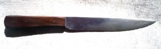

Sarge ... even on a thread about sheaths, you really think you can get away with posting a picture of a knife in a sheath, and giving us no glimpse of the blade? Cripes man ...
Just a regular old knife Tom, sharp and very pointy, blade tarnished and stained from much use at the feast table. :D

BTW: this is Andy's thread, sorry about horning in Andy, I'm looking for a good whomping stick even now
