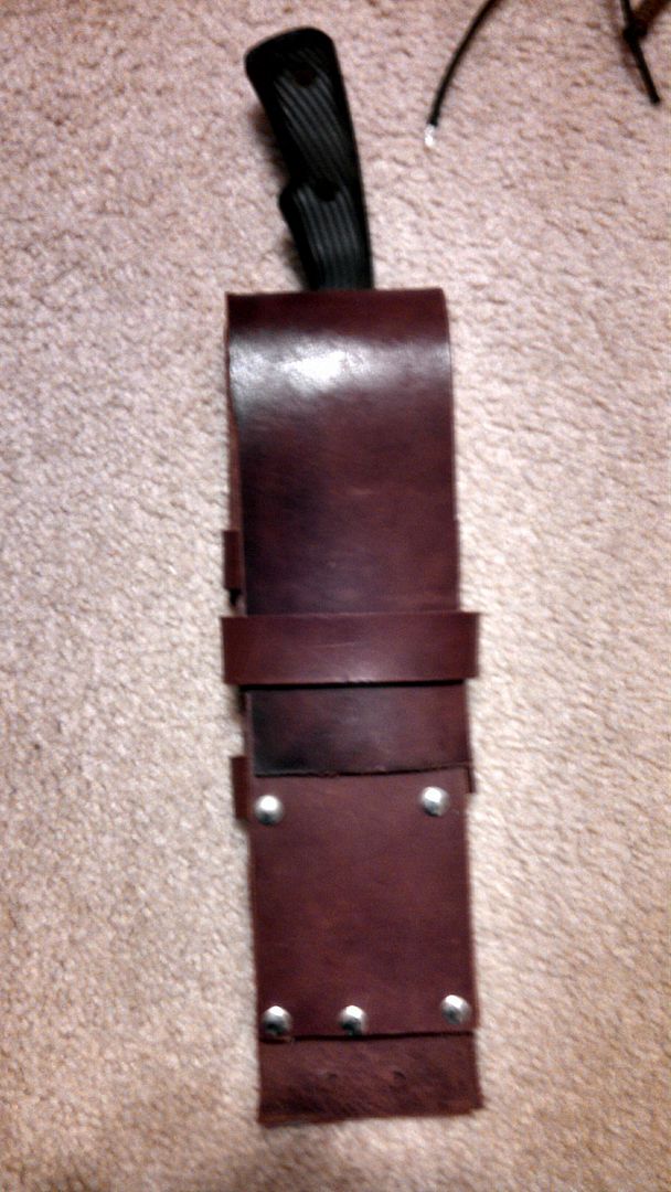

well, what can you say. If your into busse and kin. we have all had the same issue. hard to walk around just carrying the knife. I have bought some sheaths here and there, but it really adds up. So, in my quest to get more infi, I decided I would try making some sheaths.

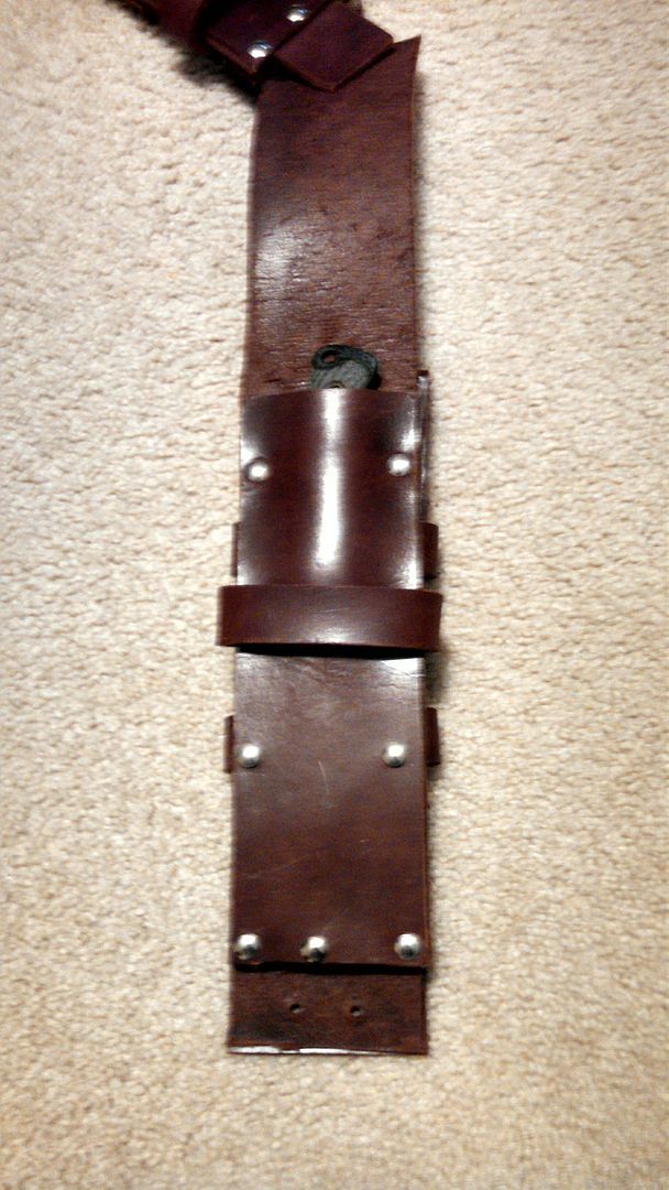

the edges are rough, but, inherent to the design. Function comes first. I used Chicago screws, so I could change things around. The most important , to me, is the ability to take the sheath apart for a good cleaning. blood, guts, dirt. that stuff finds it way in. If you plan to use for food prep, could be an issue. any way, here is the first one I made.

I also made them so no metal to metal contact can be made between the screws and the handle or blade to cut down on scratching

Chicago screws huh? Do you use a punch to put holes in the leather?

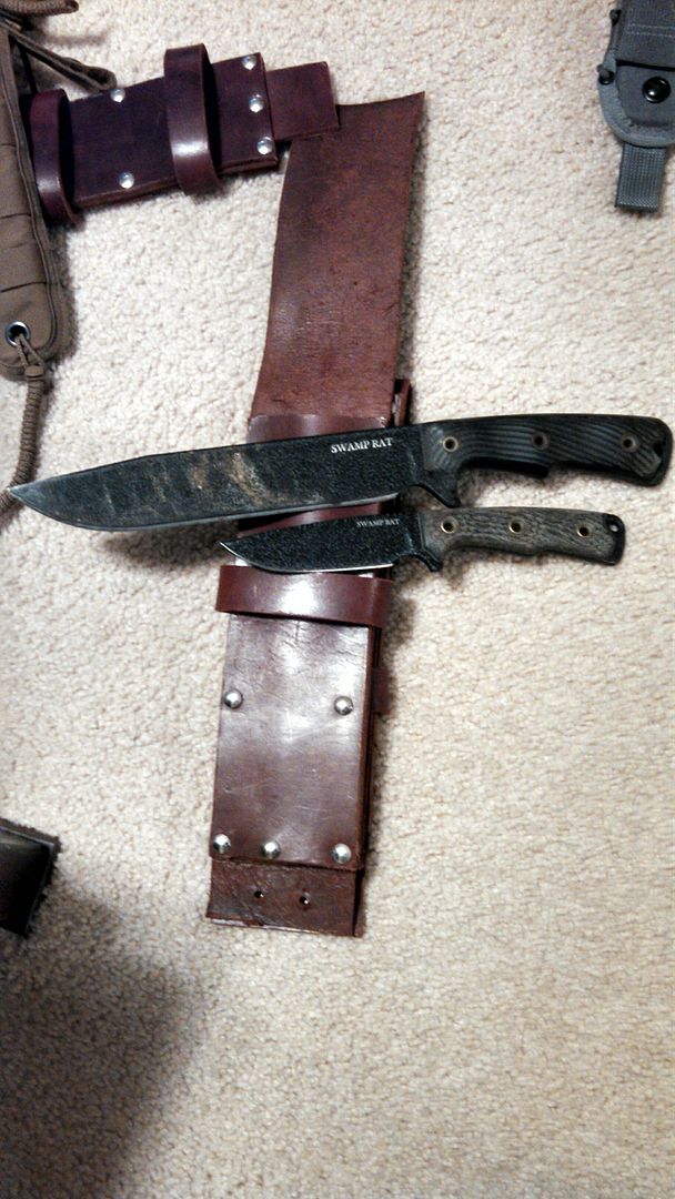

that's why I started. there aren't any makers sheaths that have the flexibility that mine do. I have patriot/skystorm, chuddy bear, azwelke, brown, armorall, ect. it does add up.

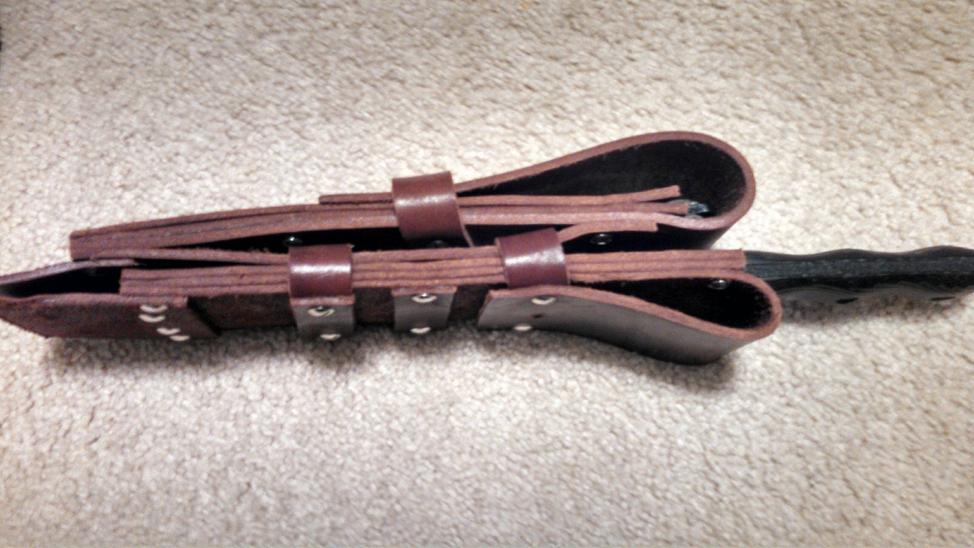

I leave the bottoms square, so I can carry right or left. Depending if I am carrying a sidearm. Towards the end of the run, I started doing some snaps and some posts. I make the keeper straps so they can be pivoted out of the way of the blade.

I used Chicago screws so I can take the sheath apart for cleaning or mods.

Matt, I'd suggest 8/9 ounce for fixed blades. Tandy carries chicago screws as well. One stop shopping. A utility knife and something to punch or drill the holes and your off and crafting. :D
the post above. I wanna say it was 8-10oz leather. screws, punch and leather bought at tandy.
