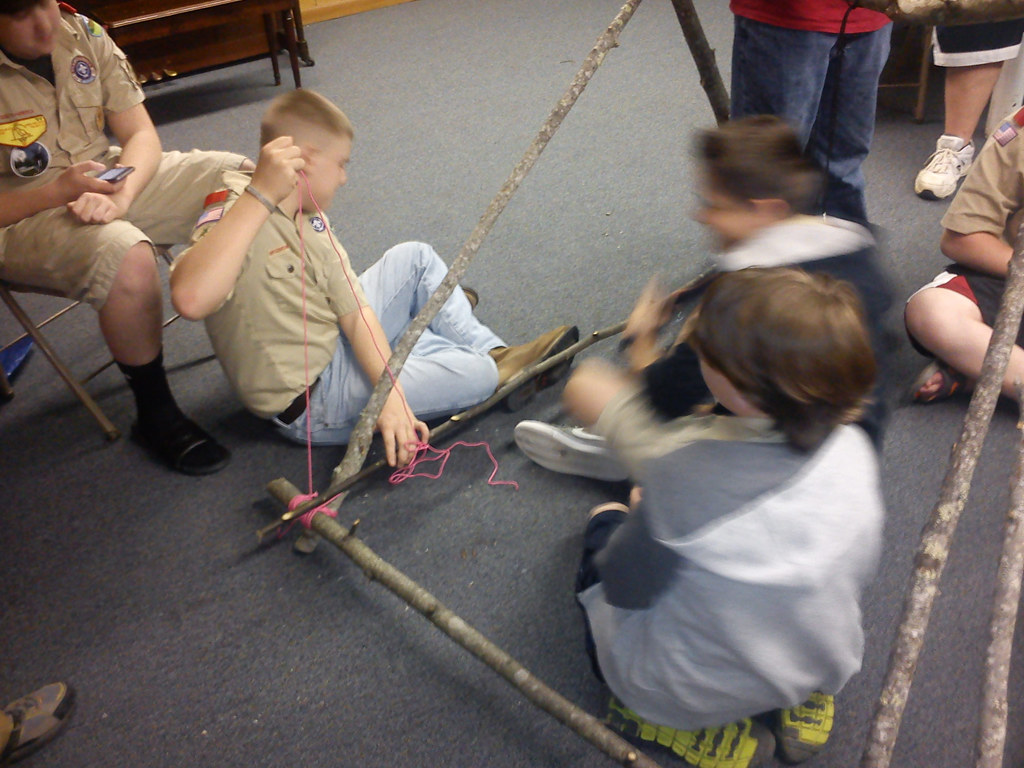

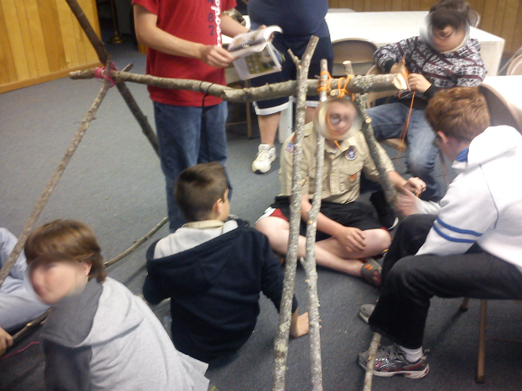

Last night during our Scout meeting we undertook a similar task, and although our shelter was not designed to be load bearing due to the size of the saplings we had at hand, our Scouts were able to construct a very durable framework (with guidance) using proper lashings as taught by the Boy Scouts of America. Had there been larger material available for use, I would not have hesitated to place a large amount of weight upon it because the lashings were very well done, and the structure was incredibly strong and stable as a result. (Sorry for the poor picture quality.)
Now our structure did not have a raised floor as it was mainly to illustrate a fairly quick framework using a tarp as the roofing material, but during our next attempt at shelter building we will attempt something more complex and I will better document the processes we use at that time.

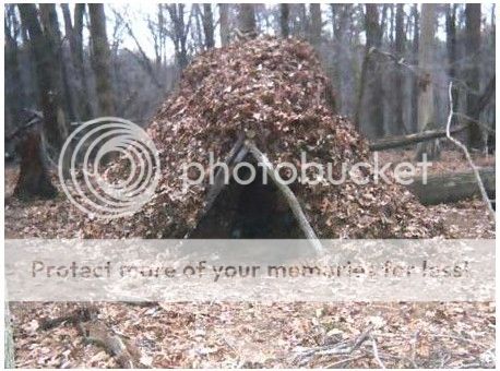

Bamboo makes a great framework for an expedient shelter. Being tubular, it is strong for the weight of the parts. The foliage can be overlapped like shingles to keep out rain. The flood control district in Southern California planted it to control erosion on the banks of the flood control channels starting in the late 1940's, so there was lots around to use for practice.
The shelter in the OP would stop a light rain with no wind - for a time.
The shelter in the OP would provide no insulation against cold or wind protection as it has no sides or bottom.
