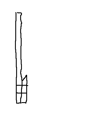

I'm talking about field expedient stuff like cutting a short piece (at an angle instead of straight across) forming a cradle to support the horizontals. A couple of loops will hold it against the uprights. Here's an architectural drawing I spent a couple of hours doing.
Good god that is majestic! I hear what you are saying, that would definitely improve the stability. And a proper shear (or round) lashing would hold those pieces together nicely. That's good info. I think with a minimal amount of extra effort we could really whip up something very robust.

as to using jointery -- the bamboo we were using had minimal lateral strength, and tended to shatter/collapse in on itself if lateral loads were placed on it, so mortise and tenon joints were actually weaker than the simple lashings we were using.
another issue -- we were originally told there was only 100' of cord available, so lashings were kept minimal to make it last longer.
