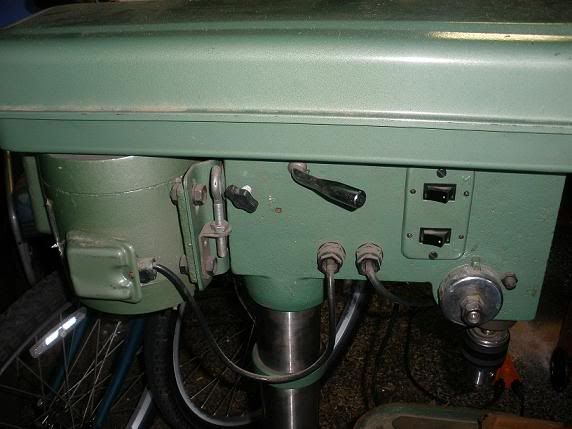

Don't think I have that. Here is a pic of the left side, top switch is the power, bottom one does nothing. There is a hole at the bottom of that housing that looks like something was there at some point... Maybe a light? The silver arm on the top I have no idea what that does either. My first guess was it was used to swap the belts on the pulleys to change speeds. However I can't seem to get it to budge by hand and haven't attempted to add more leverage with it yet. According to the manual I got the manual showed an oiler however I don't believe this has it :confused:

here you go Fletch , just to the right of the silver spring housing ( the round thingy ) is you adjusting screw , loosen the lock nut and screw it in some . Screw it in until you feel a little drag when turning the quill arm to lower it . The 'T' bolt near the motor ( should be one on each side ) they hold the belt tensioner tight . Loosen them and then the silver arm will move to loosen a pulley in order the change belt positions .
That silver arm is for tensioning/detensioning the belts when you switch speeds. You have to loosen the motor clamp screws (the black knob to the left of the silver arm in the pic, and likely one on the other side that looks the same) before anything will move, though.
