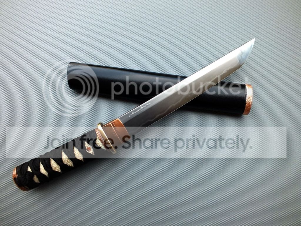

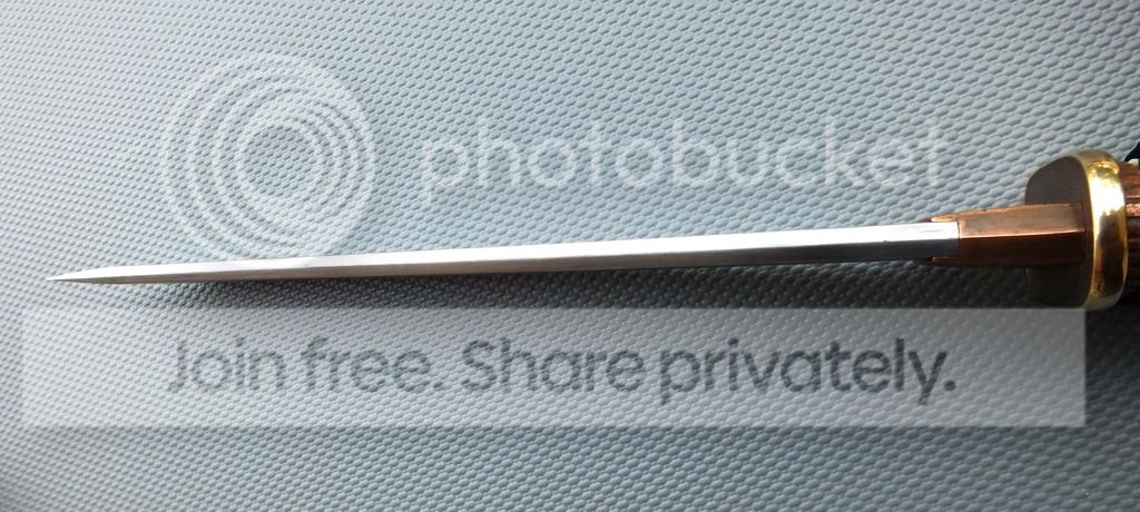

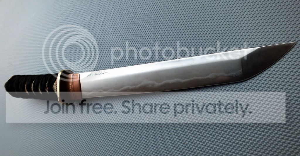

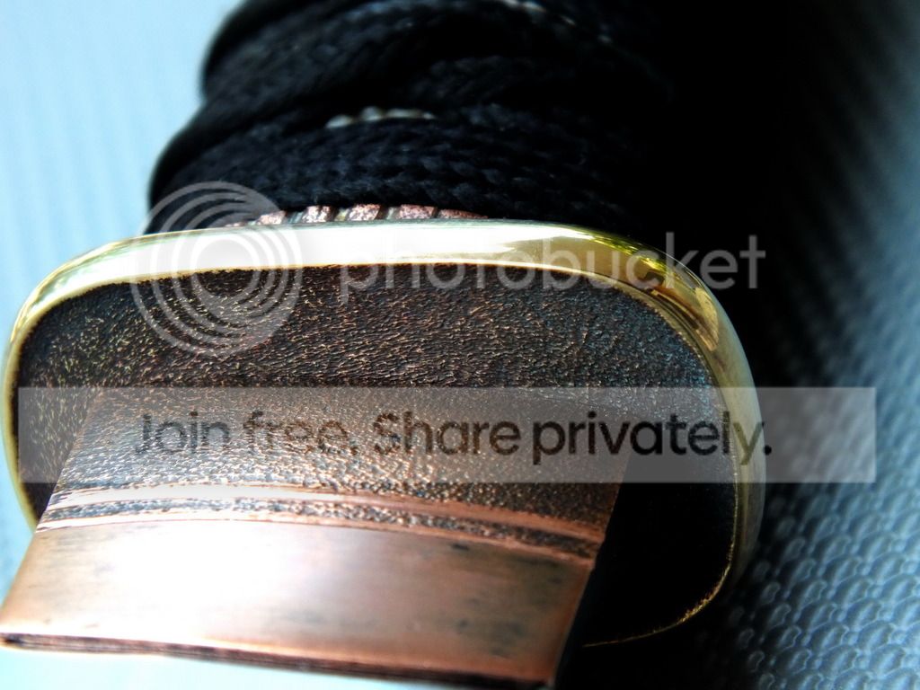

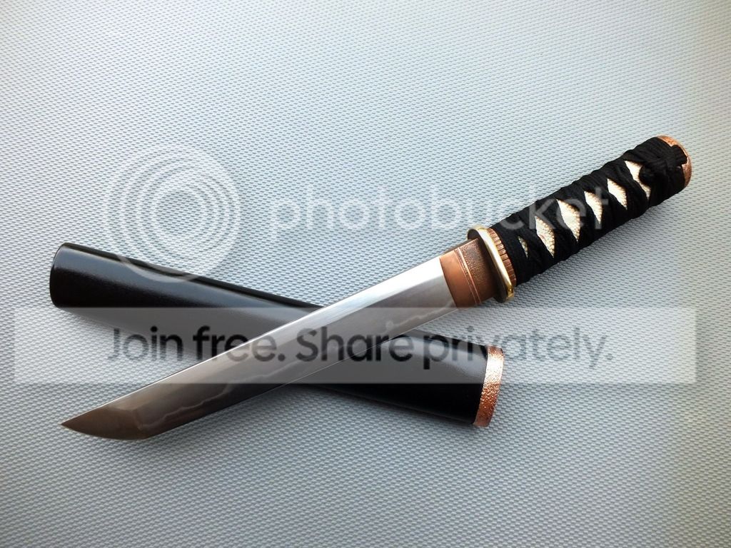

Just finished Tanto. Steel is W2. Saya and Tsuka is maple. Blade lenght 223 mm, handle 115 mm, width 28 mm, thickness 5,8 to 3 mm. Thanks for interest.

Very nice work. I really like the O-kissaki and its crisp yokote. Very well done.
My only comment would be that the koshirae should be matching. The koi-guchi, habaki, tsuba, and kashira are matched with a nice stippled pattern. The fuchi is grooved, and seems to fight the others. This draws the eye away from the overall beauty of the knife.
Compare the above to a beautiful woman with perfect figure. She has a spot of chocolate on her nose from a candy bar she is eating in a very sexy way. All you will see is the dark spot that does not seem right - and ignore the fact that everything else is perfect.
Dammit Stacy... now all I see is her chocolate nose. She is a beauty though, no doubt about it. As the saying goes "wouldn't kick her out for eating crackers" and in this case, I'd even treat her with respect (not that I don't usually)
