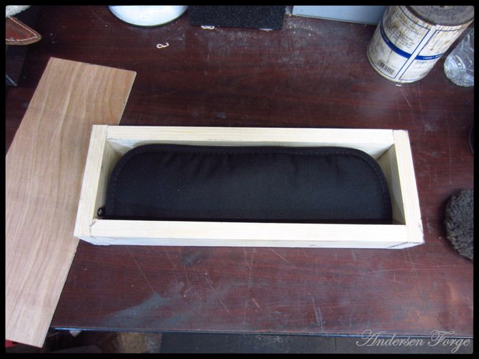

As well, I ship everything in a wooden box. It's amazingly cheap and I know of no better protection.
Nice Karl! But some of us haven't the skills to make such a nice wooden box. ;)

It's just a wooden box. :p
1x material ripped into strips. Buy a sheet of 1/4" underlayment and rip for the sides.
Why wrap it in paper?
If a fella can't make one of these, he sure as heck can't build a knife.

I think one time I figured these boxes cost me less than a dollar.
And I'm not always trying to find packaging for the knives.
I buy an eight foot 1X10 and rip it on the table saw into strips for the frames.
I buy 4X8 sheets of 1/4" underlayment for about 8 dollars.
I get a LOT!! of these boxes for only a few dollars. Stack the strips up in the corner and then cut them as I need them.
And they are so protective you can stand on the box.
Pretty cheap insurance, and it impresses the customers all to hell. :D

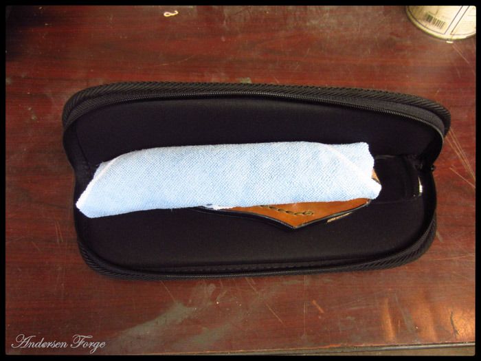

I but terry cloth cleaning cloths in the auto section at Walmart to wrap the knife in. They come in packages of 8 or 10 or something like that for 5 bucks.
Put the knife in a zippered pouch that you can get for three bucks.
So, all in all, I have about 5 dollars in packaging, but the knife is protected, shipping is REALLY!! protected, and the customers are always thrilled to be removing all those screws.
