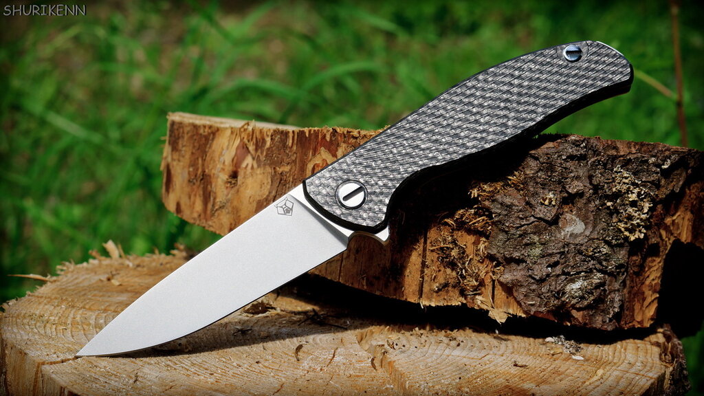

In my second review I’d like to present another great knife of Brothers Shirogorov Inc. - the modification of Flipper 95 so-called Hati. The model was introduced in 2012 year and since then has become very popular among BSI knife-users in Russia. Actually main point of modification was shifting the material of front scale from titanium to carbon fiber for lighter weight keeping the same blade and handle size. There are also some other differences in construction, that I will share below in the review.

Here is the photo with Chris Reeve Sebenza (also with CF scale)

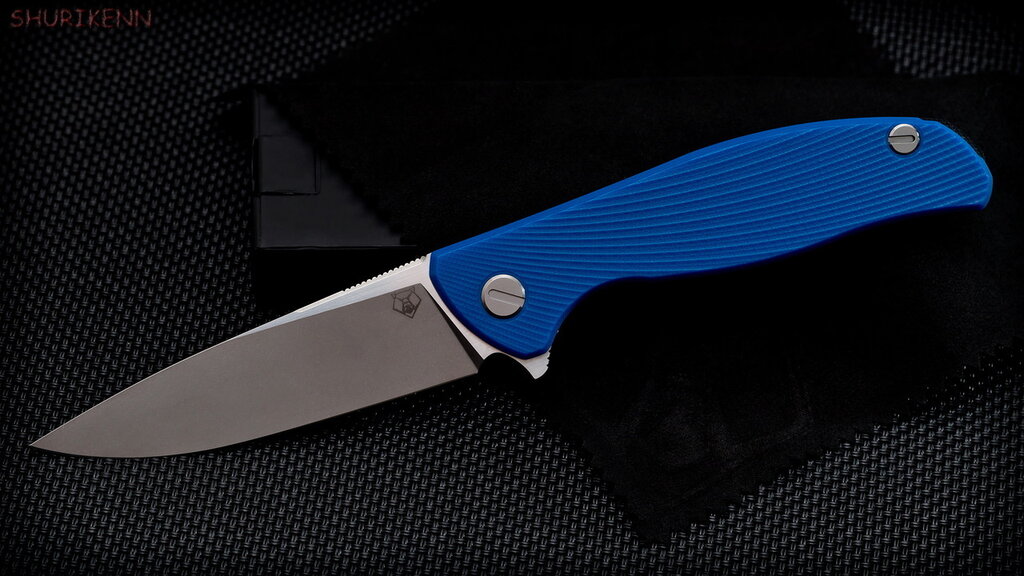

Actually let’s speak about the knife specification. As I said the general difference from the Flipper 95 is the front scale, that was firstly made from CF, now Shirogorov Brothers produce also with textured G10 scale – orange and blue for instance.
You can see that the blade can also have features.
With this feature we get a very light knife with relatively strong construction at the same time. How did they do that? The backspacer standoff was replaced with a titanium wholesome backspacer that makes the handle more solid and remove any play of the scale when you heavily hold the knife in hand. Another good perk of this decision – the balance of the knife was not affected negatively, it is one the BSI distinctive features – in all the knives they keep the balance straight above the forefinger counter.
The scale has nice long-wave pattern that grants a secure grip and also pretty look, especially when the scale is under the sunlight.
One more feature. The titanium back scale has machined pockets from the inner side, making the scale better balanced to the front scale. On the photo below is my second Hati, with G10 blue color scale and backspacer.
