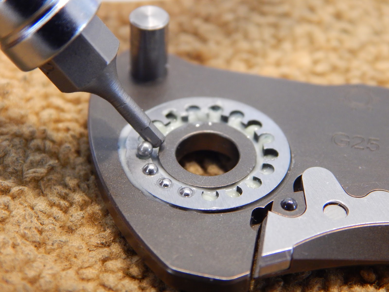

Is there a place to get a wrench that fits the custom slots on the screws? I have a 111 and an F3 should arrive tomorrow...
There is a tactical pen tool now by Shiro- but it won't fit the pivot screw for the 111. Before I got that -- was just using flat bits.
Flat #8 for pivot and #6 for the standoff and clip screw... on the usual Shiros.
For the 111 -- u need to find something wider/ thicker for the pivot.. maybe a #10 flat bit? Can't recall off hand now.
Like Shady said- -u can file down some to not bugger up the side of the screws. Alternatively tape them up once over with those labeling strip or 3m masking tape. done right it should be a snug fit and with no metal to metal contact.. lesser chance to mess things up
when opening.. push straight down directly before turning- that helps to keep excess pressure to the sides of the screws which seems to be the softest areas.
One last tip.. helps to have a magnetic tip when putting those balls back one by one... ;)

Just got my 95T and it is perfect as you would expect. Since this is my first Shrogorov knife, I wanted to ask you for some advices in taking 95T w/SRBS apart for maintenance(some DO's & Don'ts).
Thank you in advance:)
