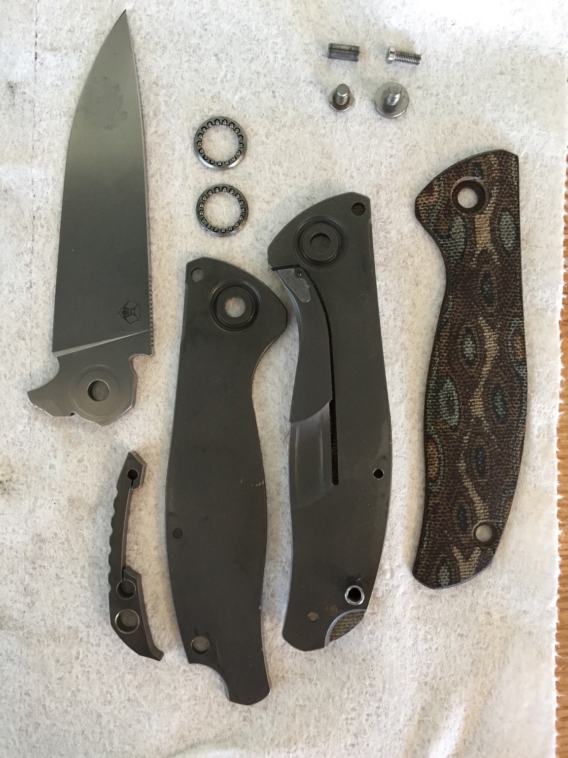

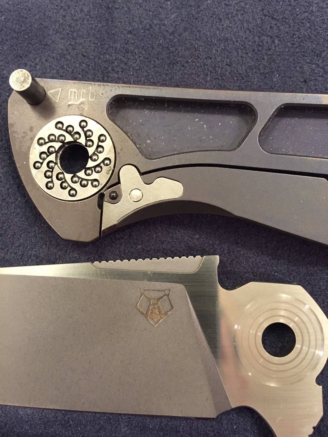

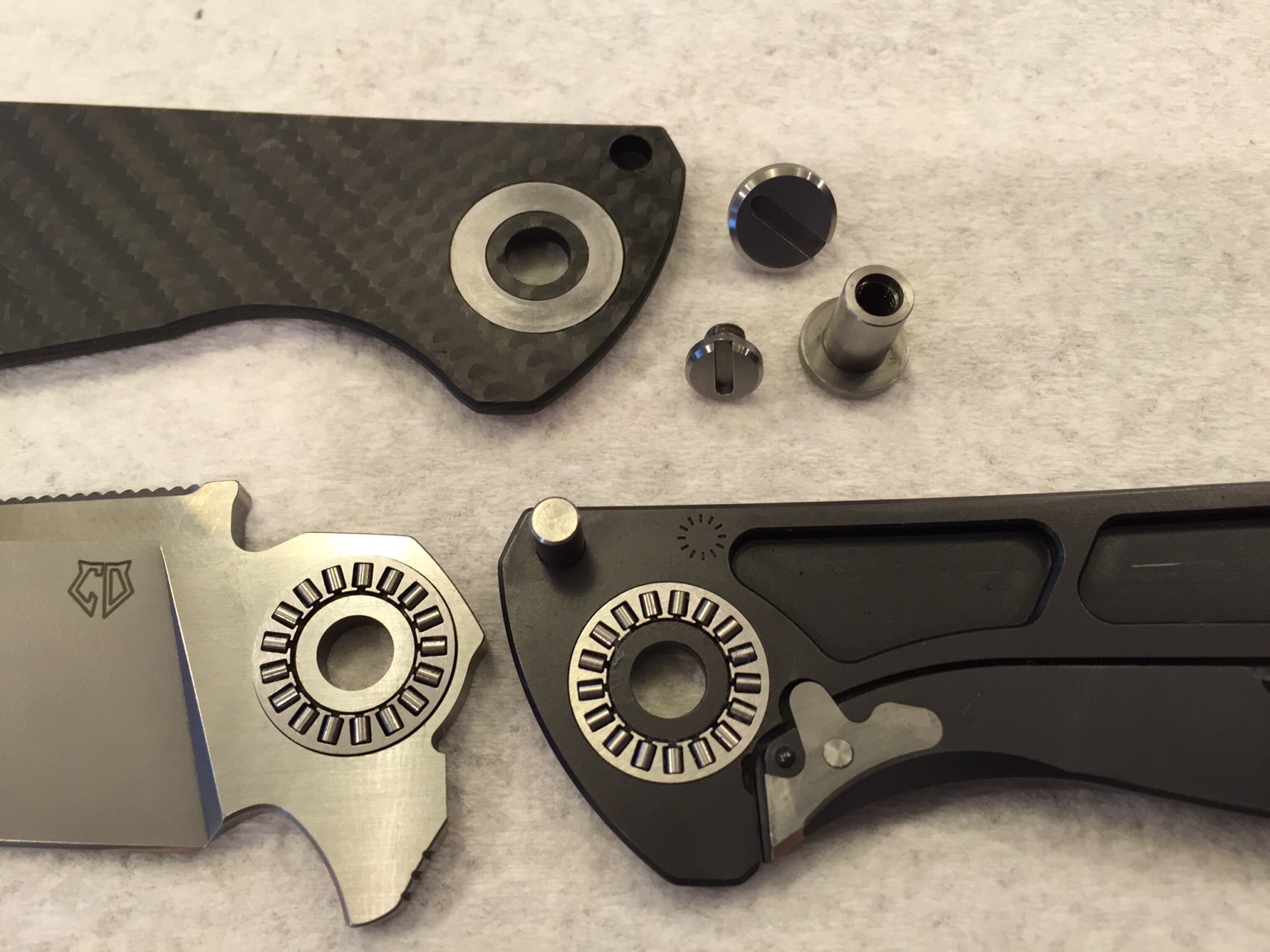

Shiro's without bearings are not especially hard to take apart, clean, lube and reassemble and tune yourself. I did my hati a few times. Bearings ones can be a little finicky if the bearings are not caged. I do not know as I haven't taken my bearing f95 apart. Just be careful and don't lose them and it shouldn't be bad.
Don't use a screwdriver though. Make yourself a tool that fits the screw (2 of them, I made them out of flat bits) and angle them so they put pressure in the base of the slot and not the top so you don't muck them up. A touch of vc3 thread locker (it's removable easier than blue locktite) when I set pivot tension and good to go.
A penny works sometimes and won't Marr the screws but if they are from factory and have theadlocker, it might not be enough to break it loose.
Shiro's are right up there with sebenzas on simplicity.
Even with the bearings, a basic cleaning and lube is a breeze. Just be sure to have a cloth down to catch any bearings that come loose.

Love BF thanks guys for all the info. Just made me not so worried about using my shiro now. Mtneer that MRBS in that shiro looks awesome. I have never seen what the bearing system looks like.
Here are some shots of my favorite "man jewelry"
Even though I haven't had my Shiros apart, I have to agree that dis- and re-assembly would be a breeze. One of the things I love about my now-two Shiros is the simplicity of their design. I would be far less worried about doing basic maintenance and minor repair on my knives than I would about sending them back to Russia and hoping they find their way back to me. I bought my 111 new from a solid, experienced Russian seller here who was communicative, reassuring, and provided tracking. He shipped when promised and it took about 10 days to arrive (exceptionally good), but I found the whole process nerve-wracking for my gentle psyche.
Mtneer helped get me into Shiros and sold me the knife in the quoted picture--it's quite cool to find it knocked down here. His pictures are insightful for anyone taking apart a Shiro. Dmitry13 's posts have numerous pics of Shiros in various states of disassembly and should prove helpful if you're contemplating working on your knife.
