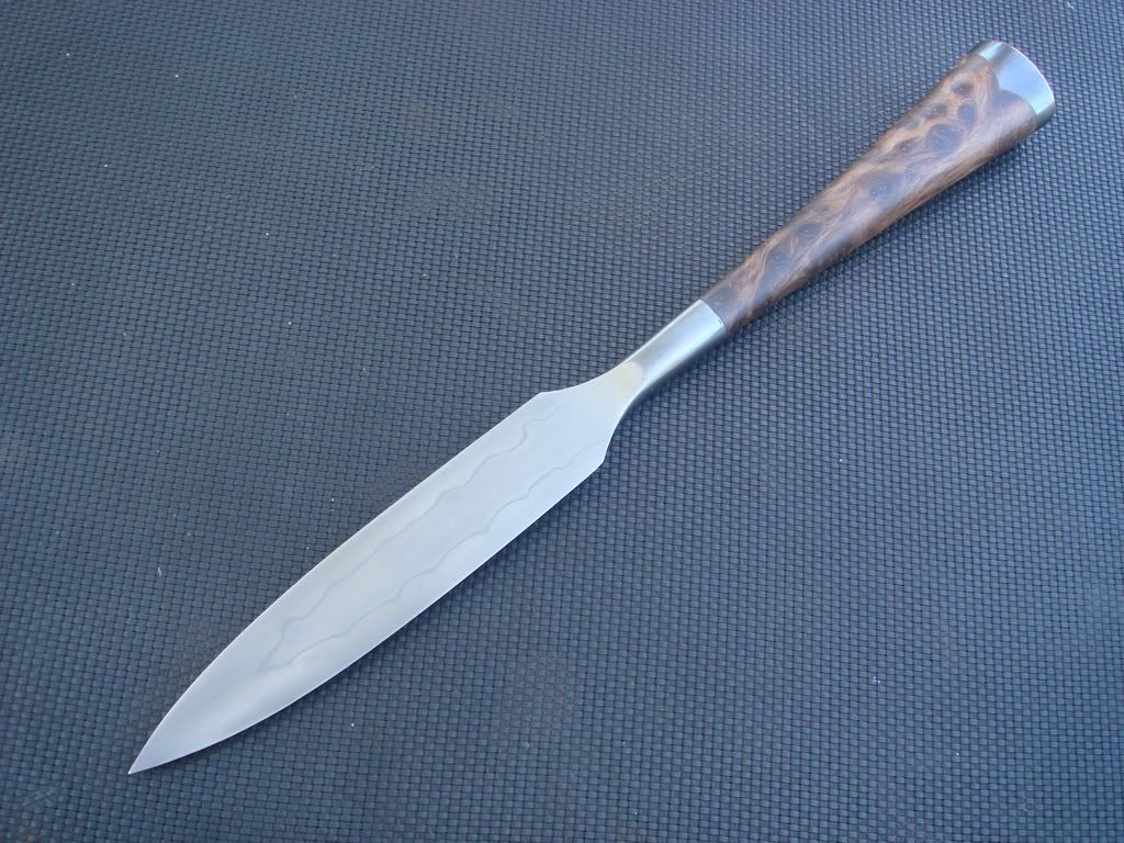

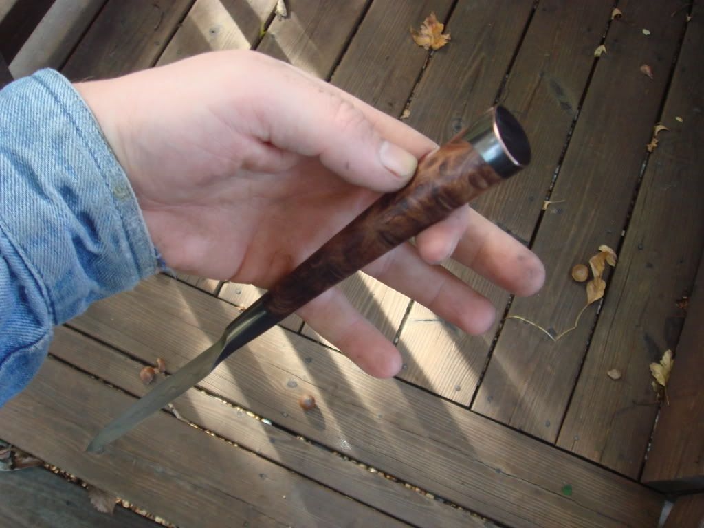

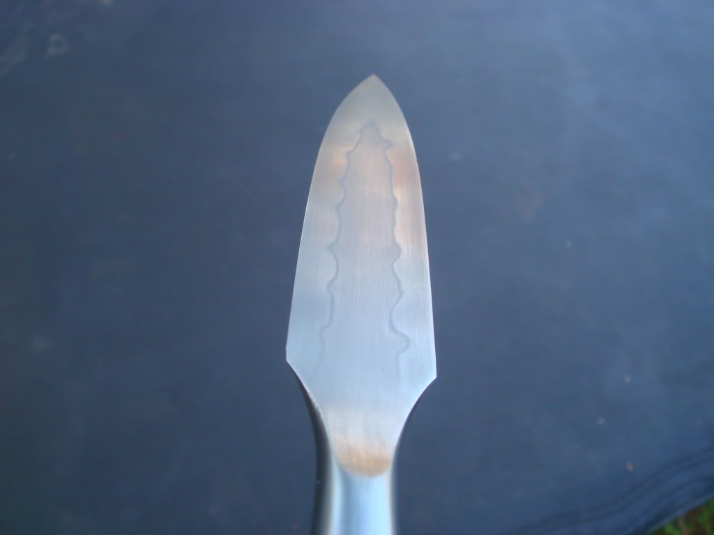

here is something i just finished.. i have been playing around with the idea since i saw pictures of Don Fogg's shiv daggers. the blade was forged from W1 and was quenched with water. (that is my first that didnt crack) also i blued the "integral" part of the blade where it transitions into the handle.. so it is darker than the pictures give it credit for.
the "cap" on the end is made from copper and blackened. the handle is redwood burl.
let me know what you think... i was going for an "antique" look. you think i could sell it?
thanks for looking!
