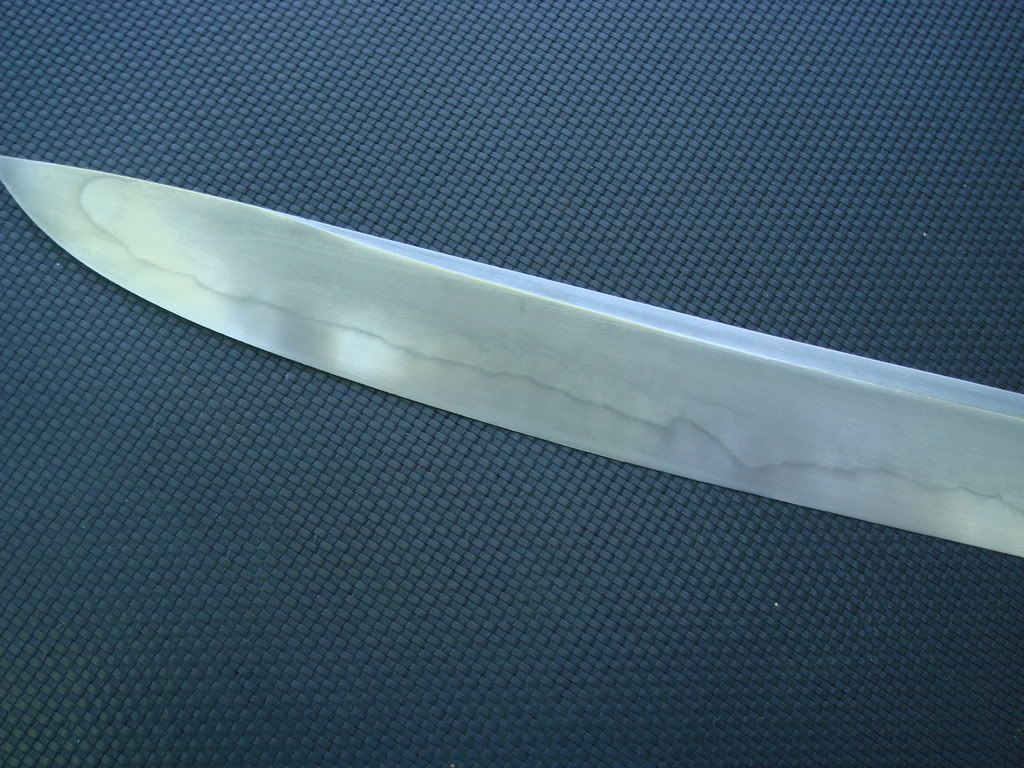

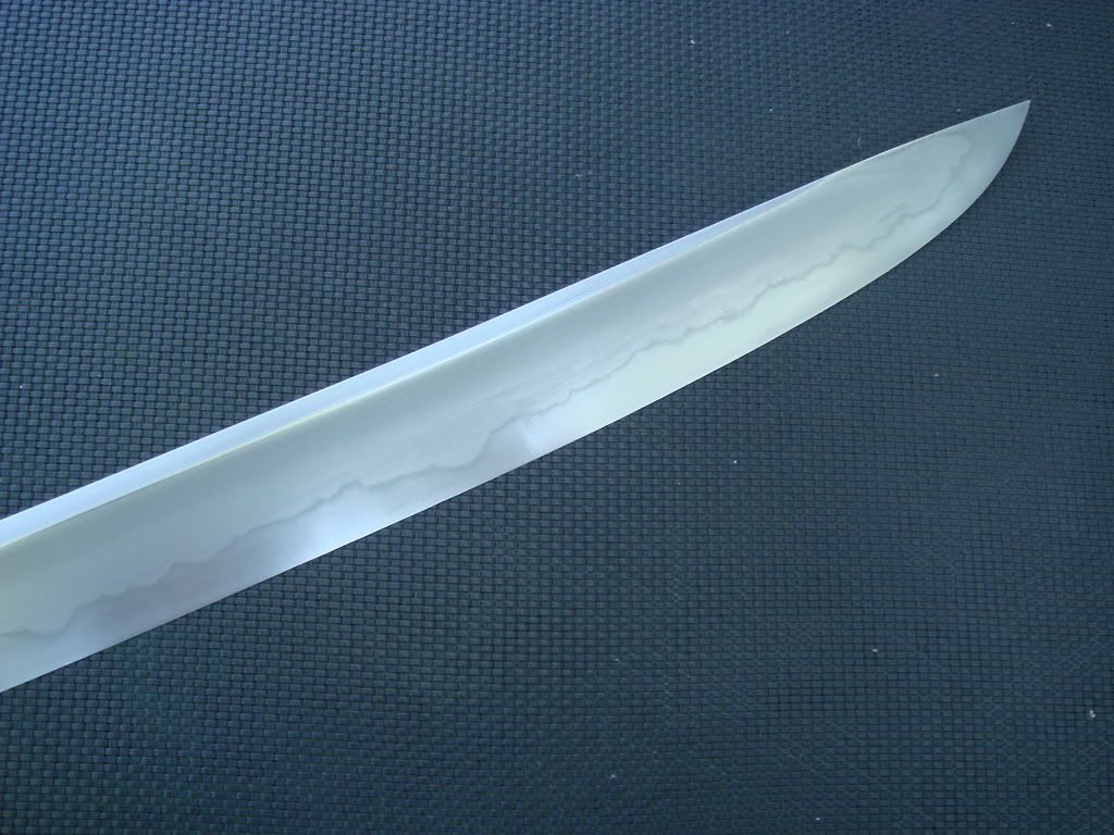

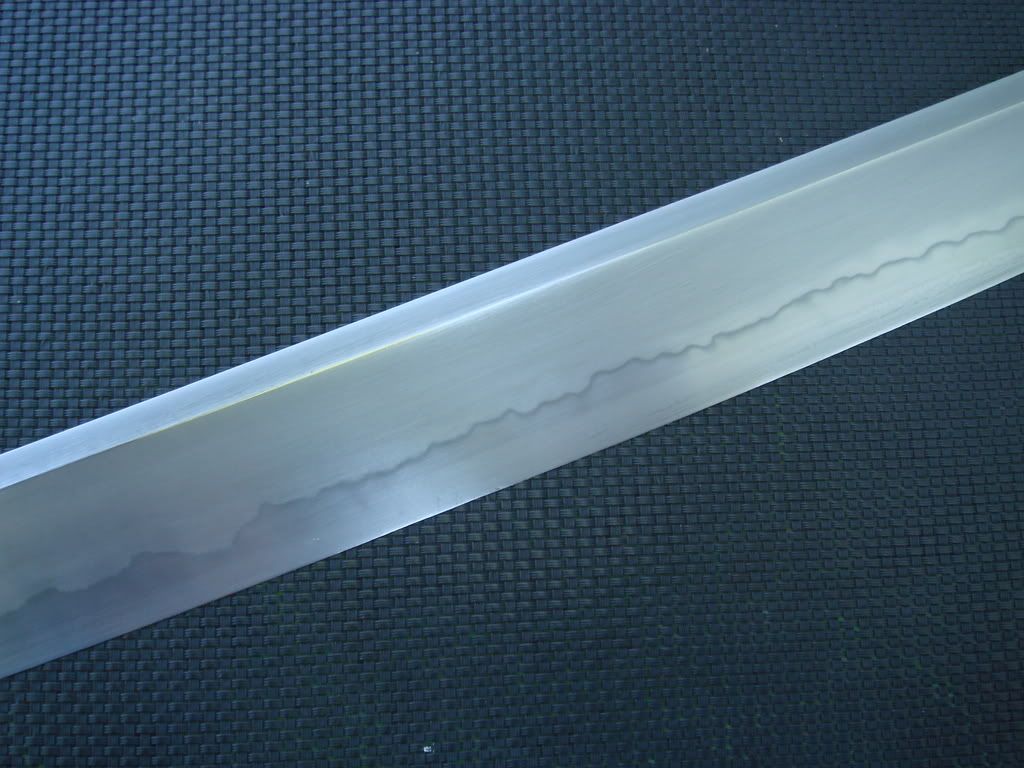

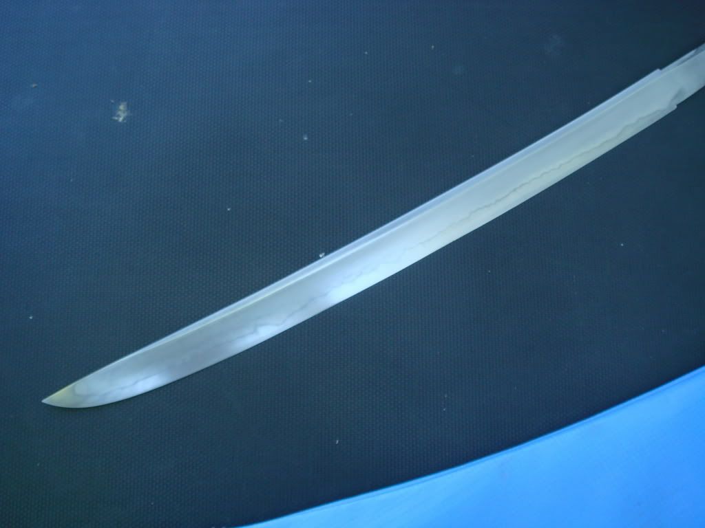

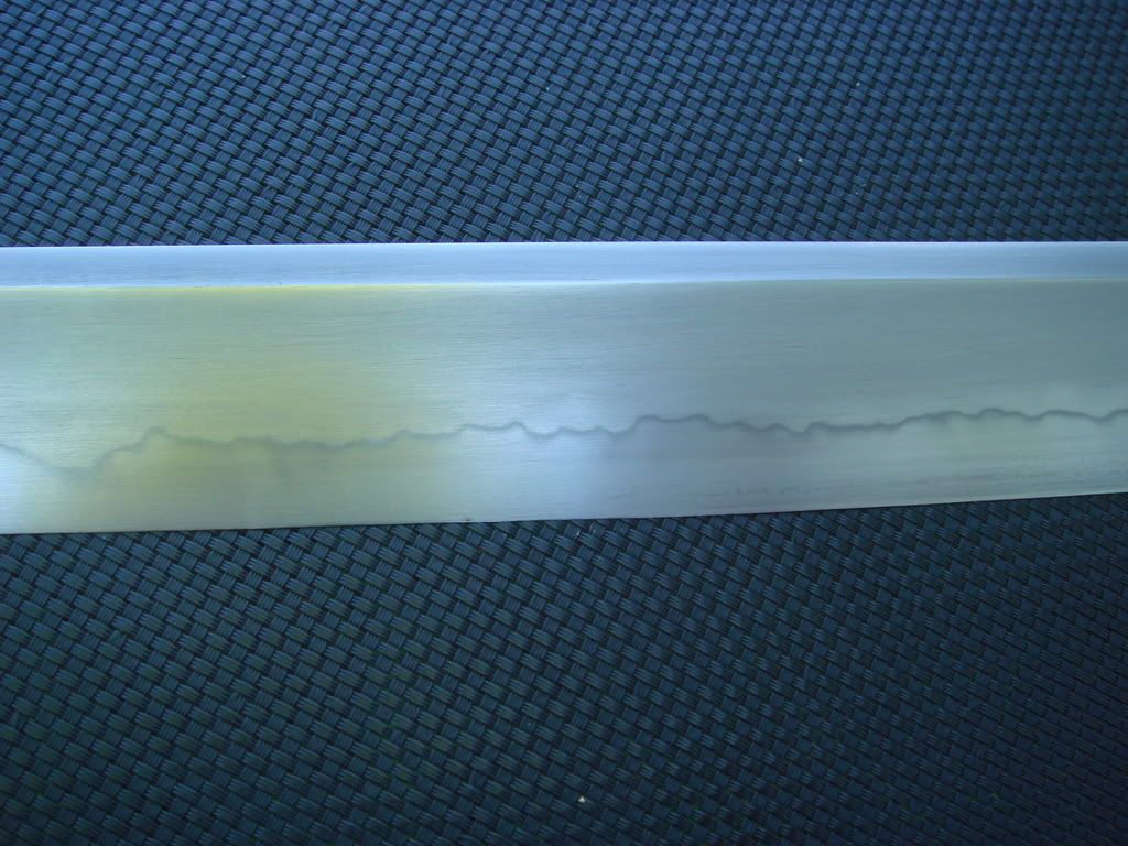

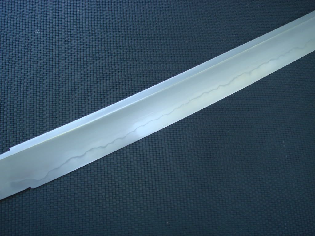

hey everybody. thanks for the help with the sword...it is the one that i couldnt see the hamon, and hte sucessor to the W2 version that broke
it has been.. er.. trying.
forged out of W1 stock, it didnt harden up the first time.. but it was already sharp, so i dulled it up a bit and normailzed and heat treated it. here is how it turned out. Used Rutland black furnace cement, and quenched in Parks 50.
these pictured were taken with the blade at about 220 grit.. and i double etteched it to see what the hamon looked like.. will take it to higher grit.. but not before i make the handle.
what would this hamon pattern be called? also, there is a "shadow" of the hamon about 1/4" above the visible hamon (from the interupted quench) but it didnt show up after i polished it. will it show up better in the higher grits?
thanks!
~Chris

Hey,Chris-first off outstanding work.I really love the hamon with the "shadow"-beautiful!In my opinion that blade deserves a traditional finish.Shawn
