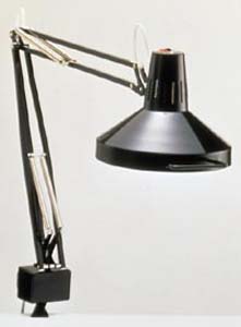

My shop is approx. 9-1/2' by 21'. I have (4) 4' 2-lamp fluorescent shop lights and (1) can light w/ compact fluorescent lamp. After visiting Nick's shop I was also inspired to pick up a couple of used drafting lamps similar to that shown below. I have them mounted at my grinding station. I should pick a couple more up for my drilling and bandsaw stations. They are very handy.
Erin
