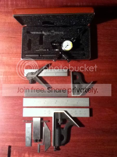

Hahaha I haven't studied it much but check out the dif in the color of my work bench when I went from incandescents to high efficiency florescence (the twisty ones that screw into an incandescent socket).
Guess that's why they call it "purple heart" wood.
