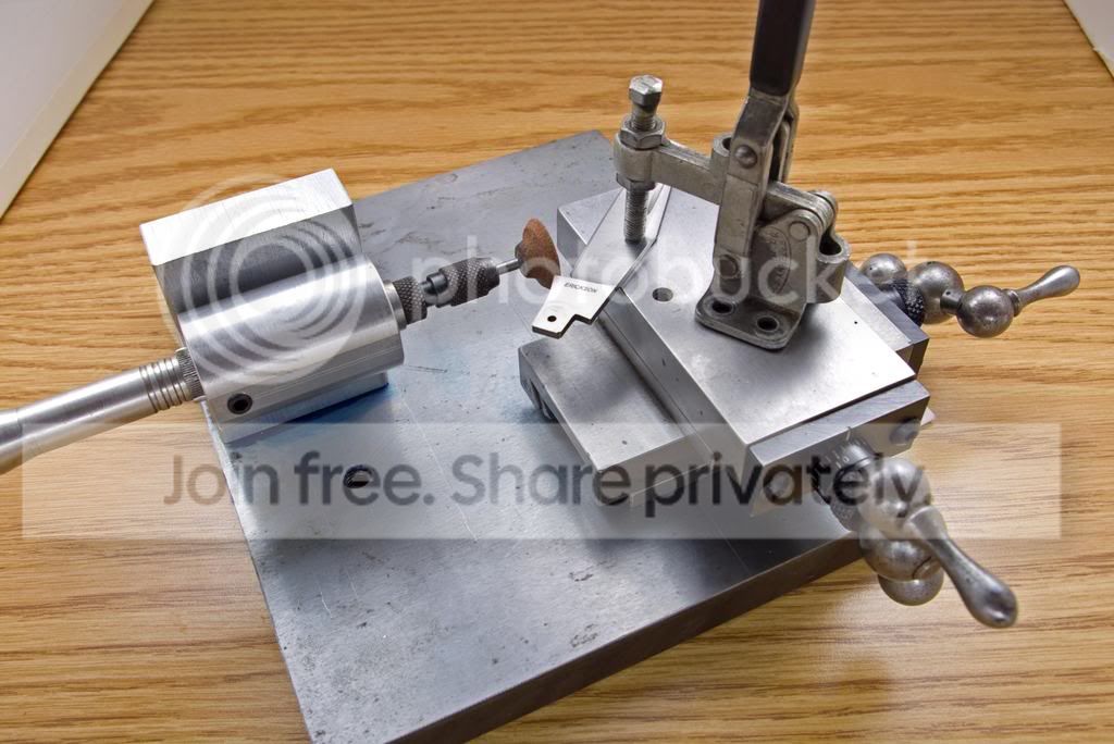

Hi,
I like a lot of you guys, like making my own tools and equipment at times.

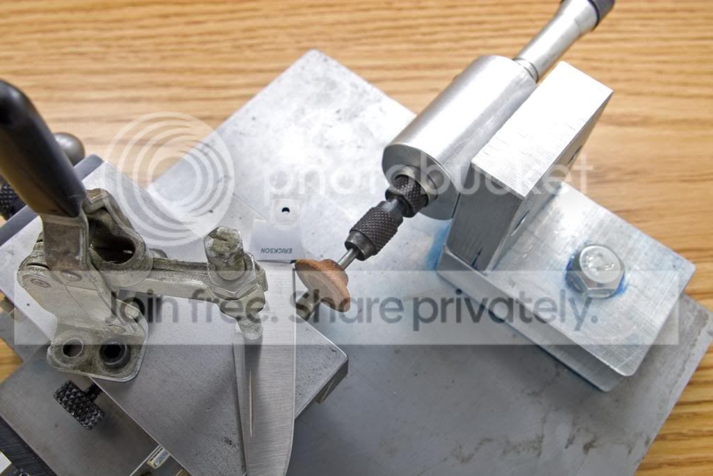

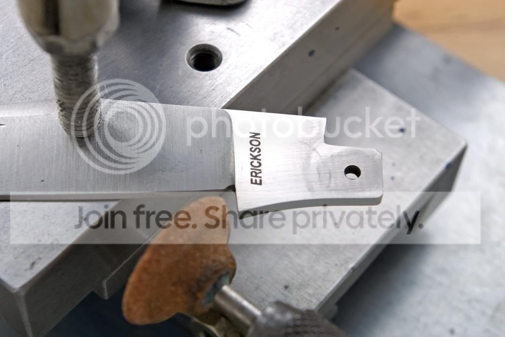

I have been making slipjoints almost exclusively and have been cutting the choils in by hand with a diamond file or hand held Dremel tool. I have been wanting to make up something with more control and repeatability.
I was in my local surplus/used machinery dealer and scored this high precision xy mini cross slide. It was new but with a bit of rust. $60 later and about a days worth of work I pretty much have it done. I made a bracket and holder for my Fordom handpiece that I rarely use. The base is 3/4 tooling plate, bracket for the grinder spindle is 3/4 aluminum. I have a bit of fine tuning yet. I will be changing the clamp system for the blades.
Thought I would share and if anyone else has pictures of there shop made equipment please share!
Ken
Very cool. I am impressed. I think you could call that a jig grinder.

really cool setups, guys! I like that mini x y table, does the clamp leave a mark in the blade?

My rockwell on the blade is up around 59 or 60. No mark to speak of. This was a test blade. I would cut the choil before the final finish was given to the blade. I think I am going with two hardened thin heat treated clamps instead of the toggle clamp for my final version. I had this toggle clamp handy and there was the one hole drilled and tapped in the top of the slide. I will post a picture after I make the new clamps.
