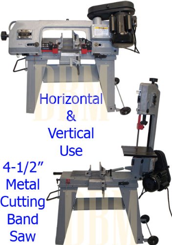

I was just wondering a few things about making knives, small hunting knives that is. My brother and I were considering trying it this winter. He's got a pretty well stocked shop, but I think that we will need a few more things, like a belt sander and maybe a vertical metal cutting band saw.

If you are only going to make a couple knives you can do it with just hand tools. Look up Trollsky on youtube,he has a good video using basic tools. If you plan on making more than a couple I would def. get a belt grinder,and a drill press. A band saw would be nice but IMHO not a necessity.

A bandsaw is nice, you can use a hacksaw, but a HF portaband, or a good brand - or a 64.5" bandsaw from Grizzly or HF will work.
They beat hand sawing buy a mile.

About the band saw. Is there any reason I shouldn't just use grinders and cut off wheels to shape the knives? Is annealed 1084 as soft as your basic structural steel? If so I don't see why I couldn't just use what I already have. I'd still need a belt sander for grinding the bevel and sharpening of course.
You have a " horizontal metal cutting band saw"
what do you mean by that.?
A large horizontal cut off only ?
The small ones, can just be bolted in the upright position and used that way.
I use an angle grinder to cut out the profile roughly. I can't hit tight corners, and I stay about 1/4" away from the outline. Then I clean it up on the 2x72. Doing it this way, it only takes about 2 mins with the angle grinder, and maybe 3-5 mins with the belt grinder.
The band saw is from the 80's I think. It's just a cut off/chop saw that happens to be a band saw. I may be able to modify it though.
