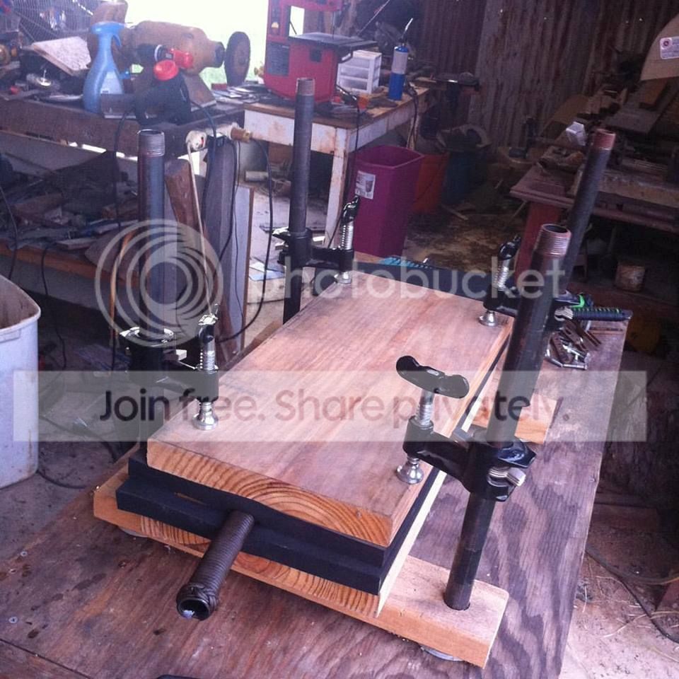

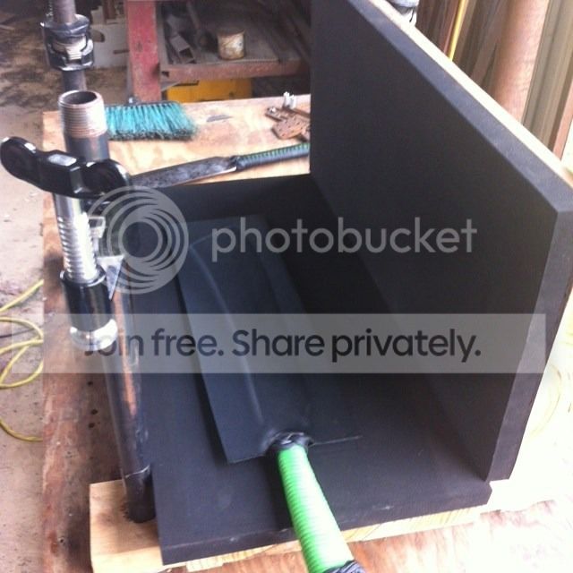

Kuntzi66 - For smaller stuff I have one of KnifeKits' Kydex presses. For the long stuff, I use this setup that I built:
It works pretty well, but I have plans for something with a scissor jack and an electric impact wrench to make it quicker. With Kydex, faster is better. That's down the road at some point.
