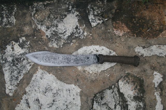

This was the quickest turnaround time on any order I've ever done, and it was just happenstance. I had a fellow call me up wanting a shorter version of a bush sword that he had seen posted on a bushcraft forum. This particular bush sword is on my business card in a picture showing it having cut through a tree almost as big around as the length of the blade. He wanted a shorter version, which would really take it out of bush sword proportions into large camp knife territory. I was already going to be forging another bush sword blade and had a looming bill that could be eased with another order, so I took it on and had it shipped out the next week.
The blade is 10.5" including the choil, and the handle is an integral socket with marine epoxy-impregnated hemp wrap and two-strand Turk's head knots.

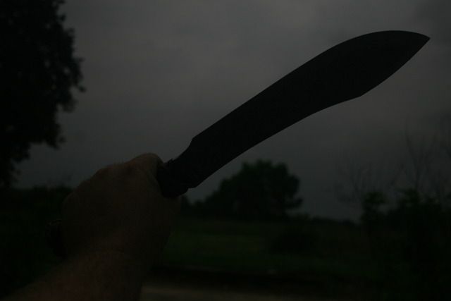

A shot of it in hand with my camera acting funky.

What is the blade thickness on the long bush knife you made for him? Cool, very nice.
Thanks, guys!
Camber - Haven't taken any measurements, but I'd say in the 6" to 7" range. I have a few longer blades still to forge, may have a cleaver design in there. Nothing on the scale of the Carcass Splitter this year, though. :)
Cbach8tw - I forged it from 2" x 1/4" 5160, but I'd say that the spine is no more than 3/16" at the thickest spot above the chopping sweet spot. I do my work largely by feel, and this is nice and light, though I didn't take measurements besides the blade length.

Thanks James...I was just curious of the general length, so you answered my question.
And that Carcass Splitter was awesome, and while I totally get it if you don't get a chance to do a cleaver, it's just one of those blades I associate with you and Blade. You should do a 14" Goat Cleaver! That's one of my favorite designs of yours.
