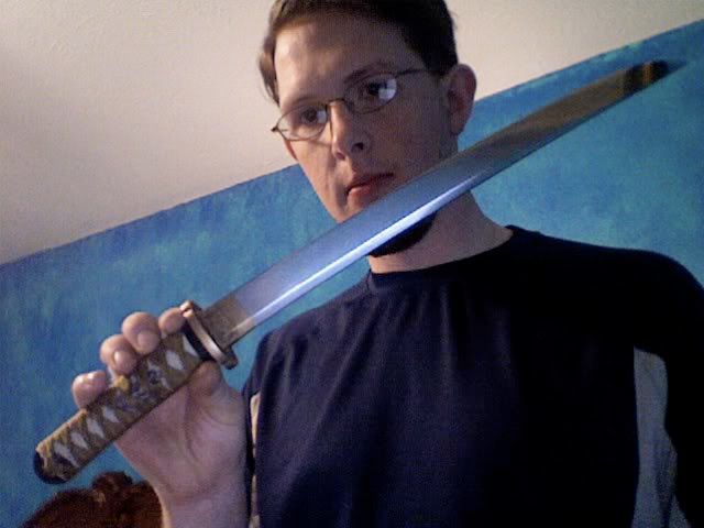

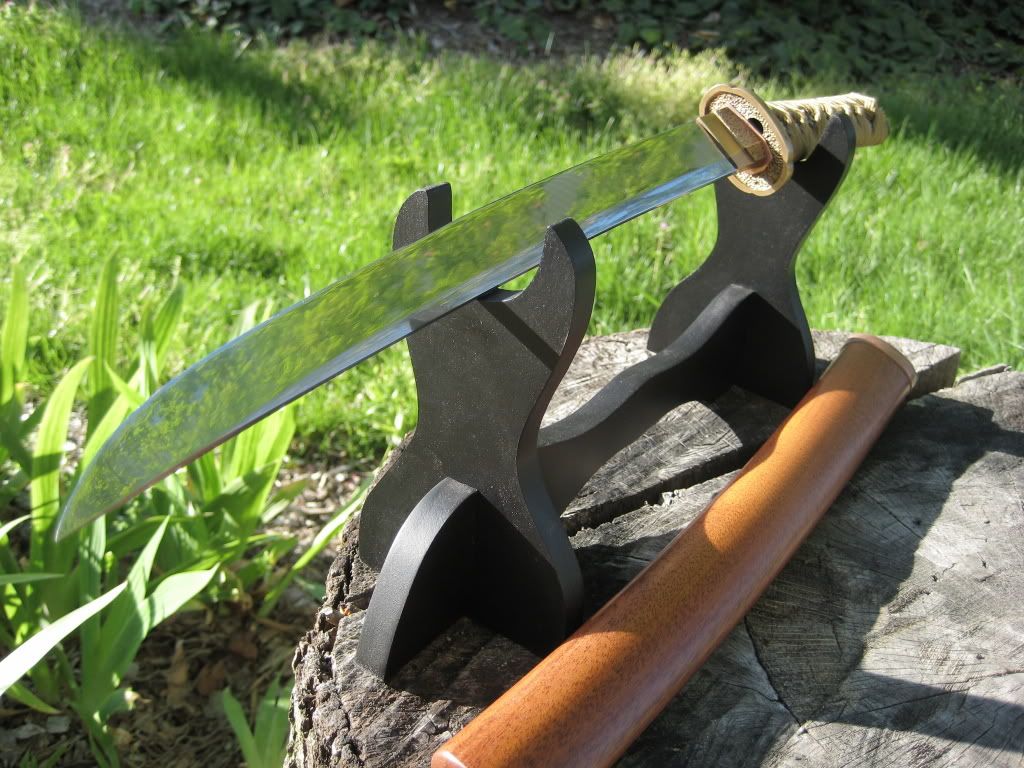

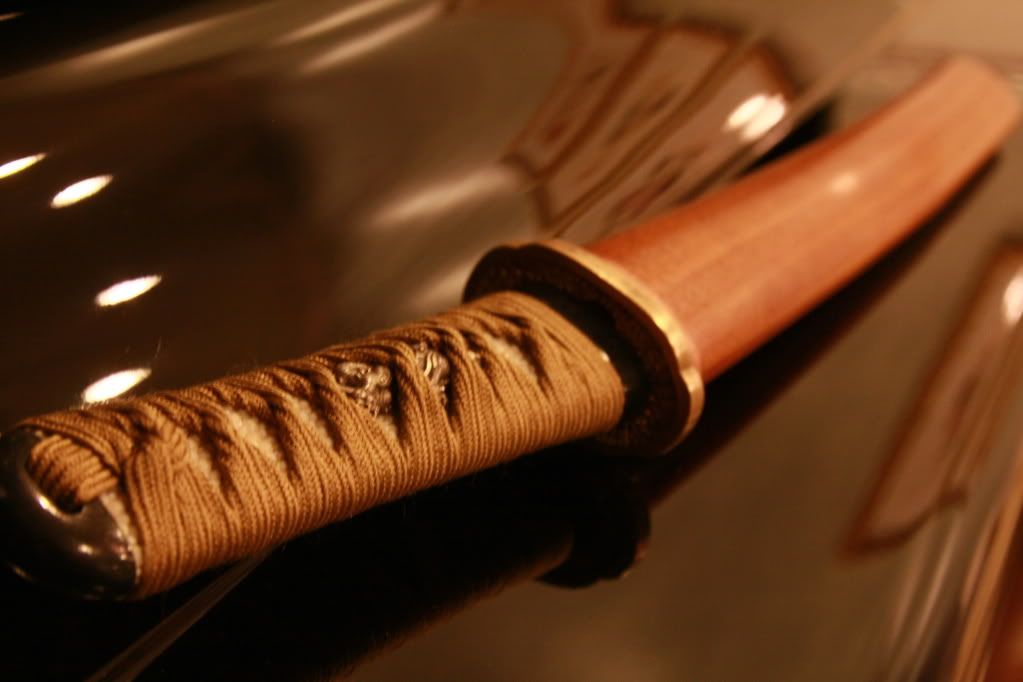

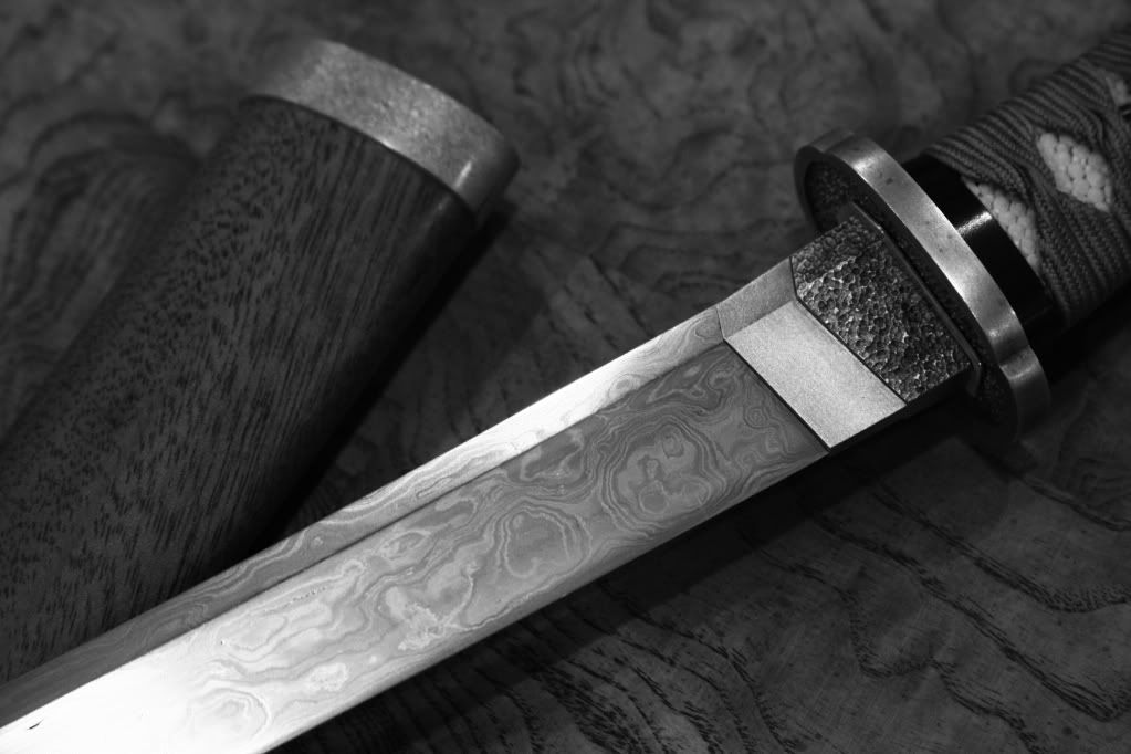

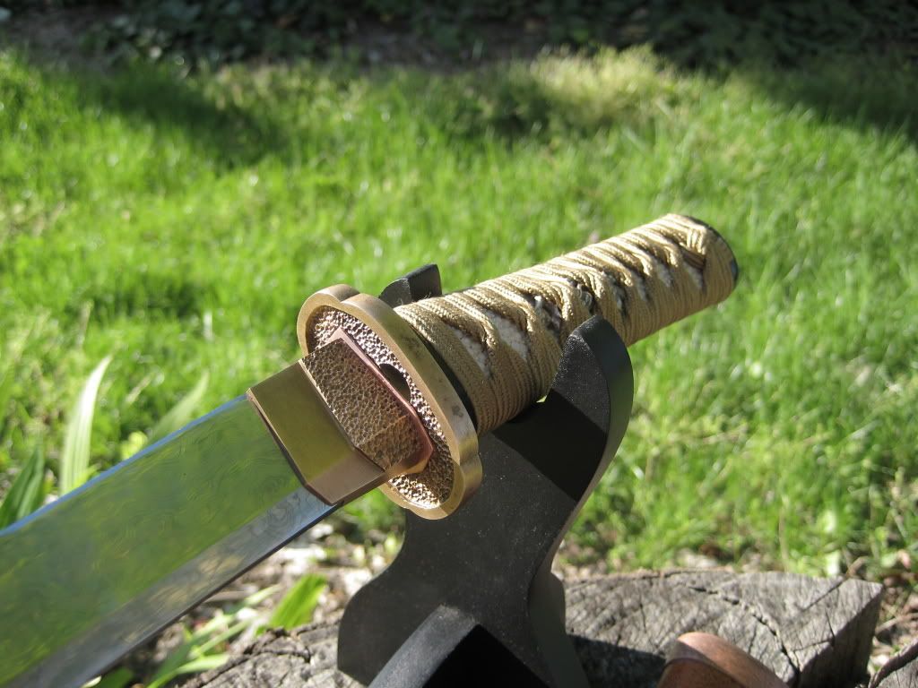

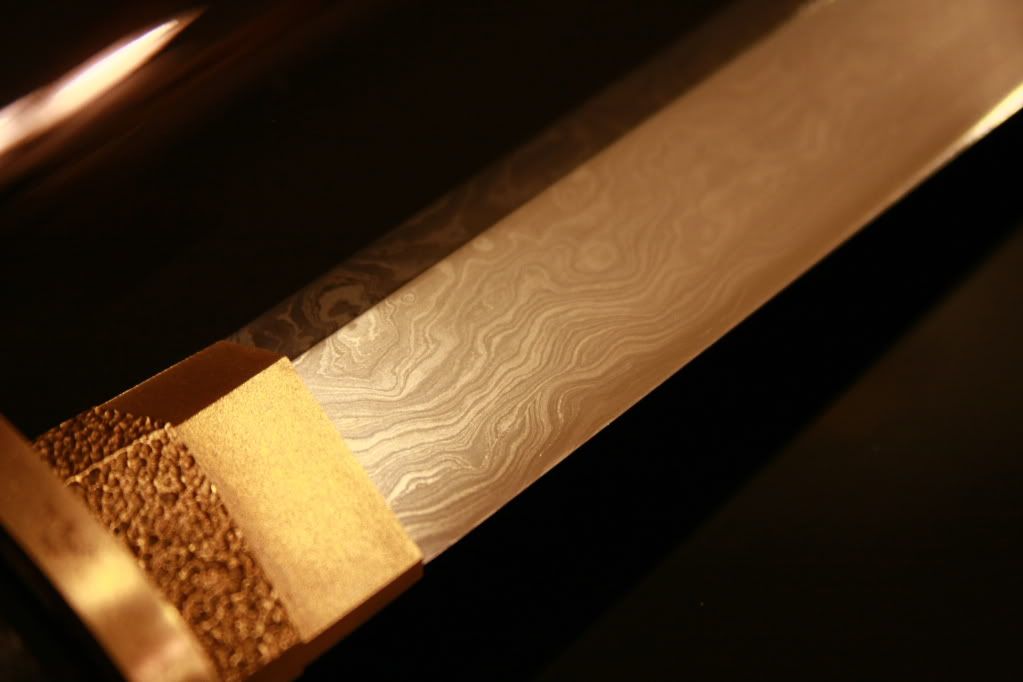

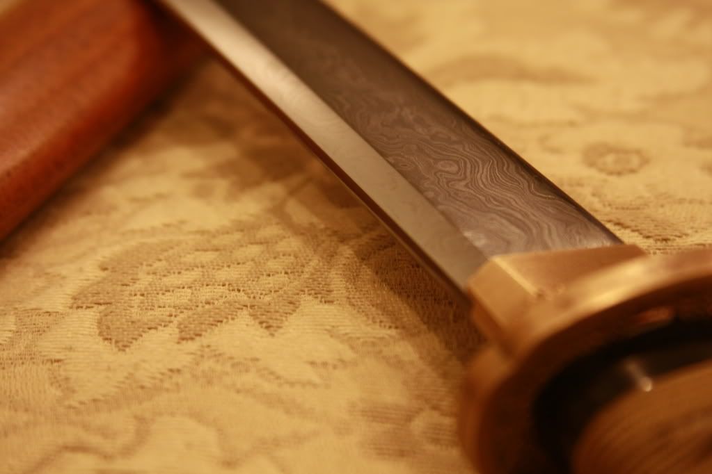

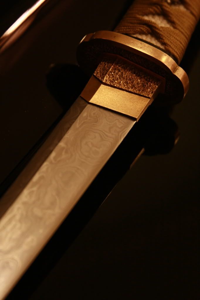

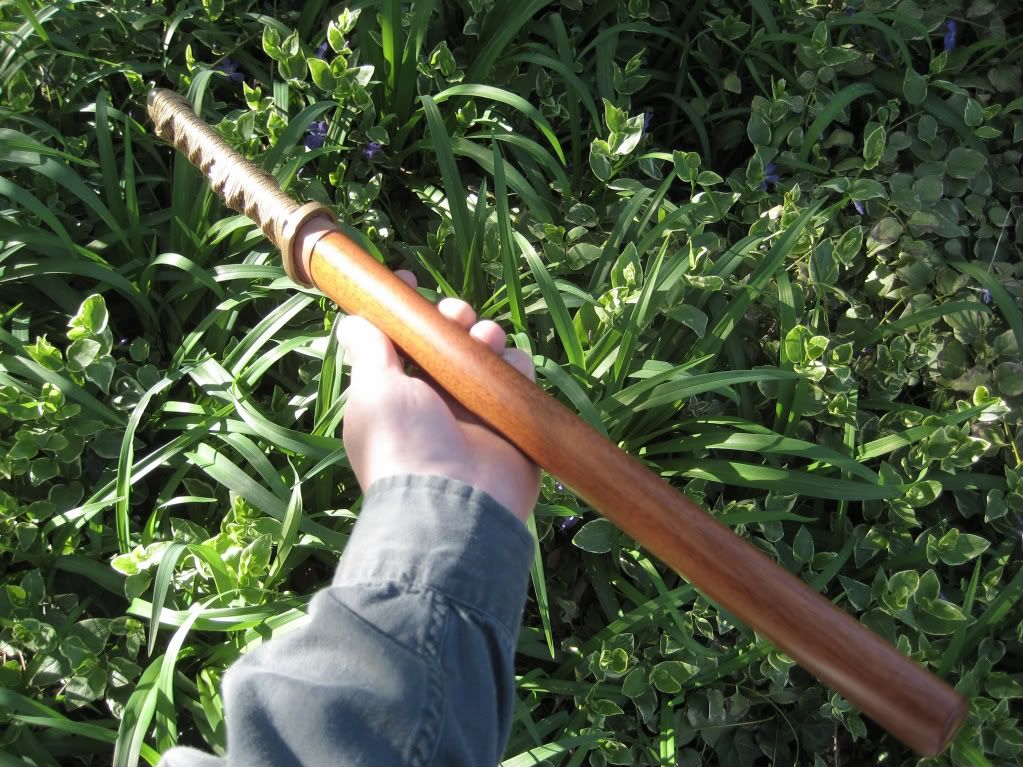

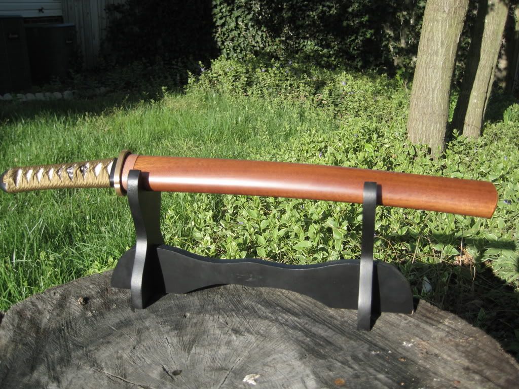

been a while since i posted.. been crazy busy. Working full time going to school, and getting married! this little wakizashi was made as a trade for a diamond, and help assembling my fiancee's ring. I am not sure how many layers the blade is.. and the pedigree of the steel is sketchy...I got sori when i water-quenched, but i didn't get a hamon. *scratches head* The saya is mahogany, the tsuba and habaki were cast in bronze from waxes i made. The menuki are sterling silver, and the ito is silk. My brother with the nice camera got some pictures... i will get some less-abstract photos soon.
i would appreciate your comments and criticisms.
thanks for looking!
~Chris

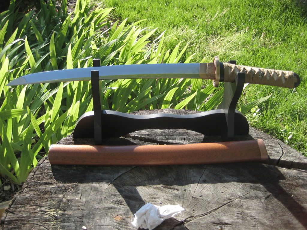

the sword is 19.5" oal and 20.5" with the sheath. it isn't a large wakizashi. i only have a couple pictures of the whole sword on my webcam... which are rough. i am going to get a couple much better shots later today in natural light.
more pictures to come
thanks for the comments! i would appreciate some critiques when you see the whole sword
thanks
~Chris

I like it the way it is! I think that if you had obtained a hamon, it might have confused the existing pattern in the steel. I think a hamon looks better on a blade with a more plain/subdued finish.
Thanks for the look!

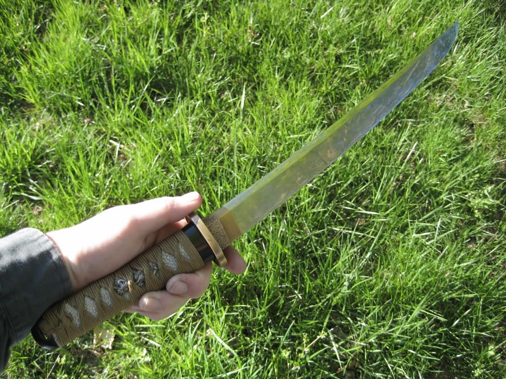

the tsuka is about 5 inches long, so yes, the blade is about 14" long. is that too short to be a wakizashi? i read somewhere the breakdown of sizes.. but i didnt write it down.
i am hoping to finish another sword (so i can wear it) by the time i get married in July, but i am going to be working full time AND taking 12 credits in an 8 week summer class. so i dont know if i am going to have the time to make that happen. So, if not.. then this is the sword i will wear at my wedding! very exciting time. Thanks so much for the encouragement, and as promised, more pictures! enjoy!
thanks for looking!
~Chris
