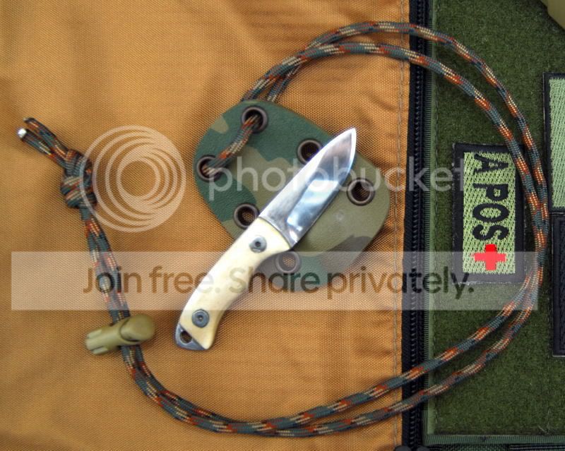

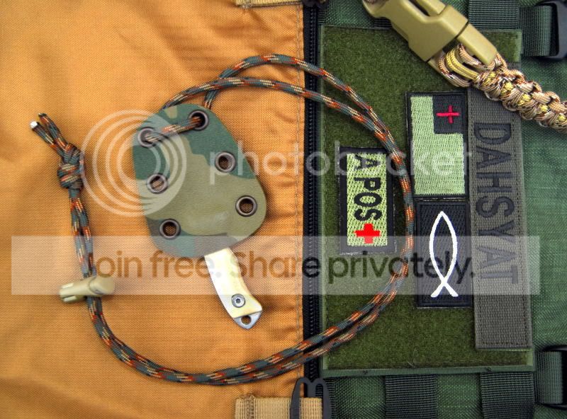

Hello everyone,
A very good friend of mine made me this small knife the other day. The blade is ATS-34 (leftover scraps from another project) with Rusa-Deer handle.
I made a neck sheath for it, so it can be with me at all times when I'm in the woods. I never had a neck knife. My question is, should a neck knife be part of a survival kit, or should I even bother carry one?
Thanks in advance...
They're handy, concealable, and if you're more likely to have a knife on you by wearing a necker, then by all means, a necker is the way to go.
Practically speaking, lots of folks who canoe or kayak like them. Easier to get to than a hip-riding blade.
Paracord is generally a no-no for the necklace portion. Given that it can support 550 pounds, should you get into a sticky position where it's twisted around your neck, chances are you're not simply going to break the cord. To reduce any chance of choking, most folks go with some sort of break-away suspension system.
For a survival kit though, I'd rather have something a bit more substantial. Still, combined with a chopping implement, you can go a long way with a small fixed blade.
SHould it be part of a survival kit? That's up to you. Could it be part of a survival kit? Most definitely.
I am a big fan of rendundancy with some items, especially edged tools. Although for a neck knife, I'd rig it on some sort of break-away lanyard to minimize the possibiliy of inadvertantly hanging yourself. one thing you can do is make a closed loop out of a piece of paracord by making a 3-4 turn slipnoose knot around a plain end. I usually burn the plain end so it mushrooms a little, just to give it a little bit of resistance before it slips through the knot.

I agree with others here about hanging paracord around your neck without a break-away. Here are some options I have come up with:
  • Tie loops in the ends of the paracord and join it with a short loop of chain.
  • Gut the last 1" of the cord ends and slip them through a short peice of vinyl tubing or heat shrink and then melt the ends to form balls on the ends to give a little resistance to sliding through the tubing.
  • Check a bead shop for commercial necklace clasps. I've been looking for the perfect pastic fitting for neck lanyards.
  • My favorite is to run a chain through silicone aquarium air tubing. You can use the tubing for drawing water from cracks and seeps. It spreads the weight out on your kneck and doesn't absorb sweat and body oils like paracord will.

Thank you folks for all the comments.... :thumbup:
I can see how not having a breakaway clasp can very quickly ruin the day... :eek:
I looked around and found that even my ID card holder from the last conference has a breakaway clasp. Well...., goodbye ID card holder.

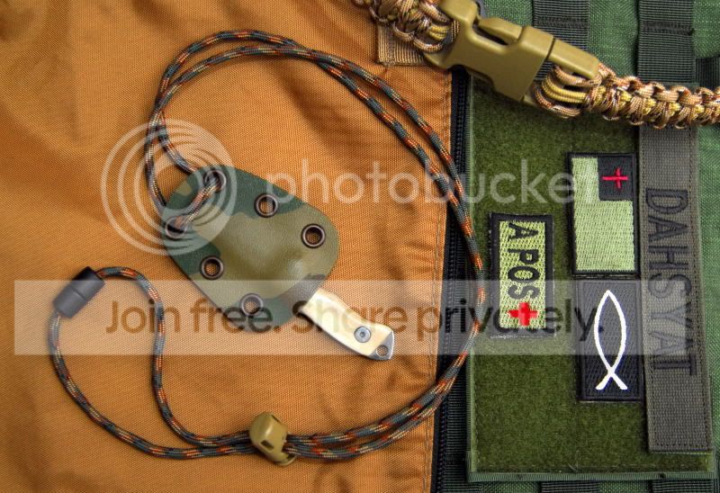

I have made the adjustment as suggested. Here is the new set up with the safety device installed.
Thanks...
Anyone know where to buy those spring loaded cord clamping things similiar to those in Dahysat's picture?
