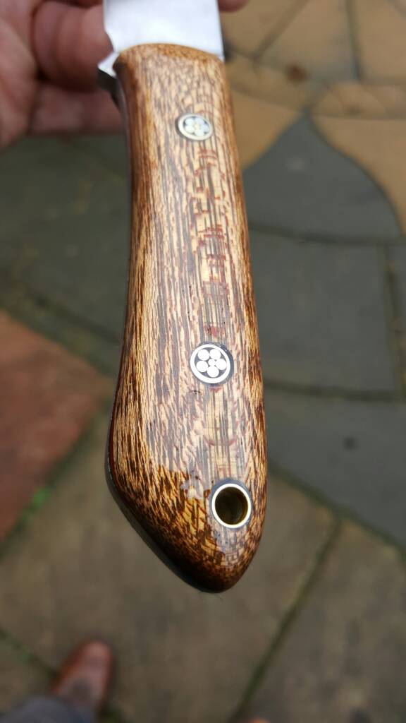

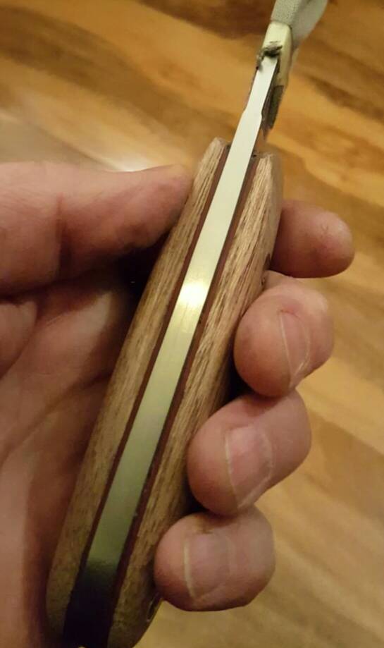

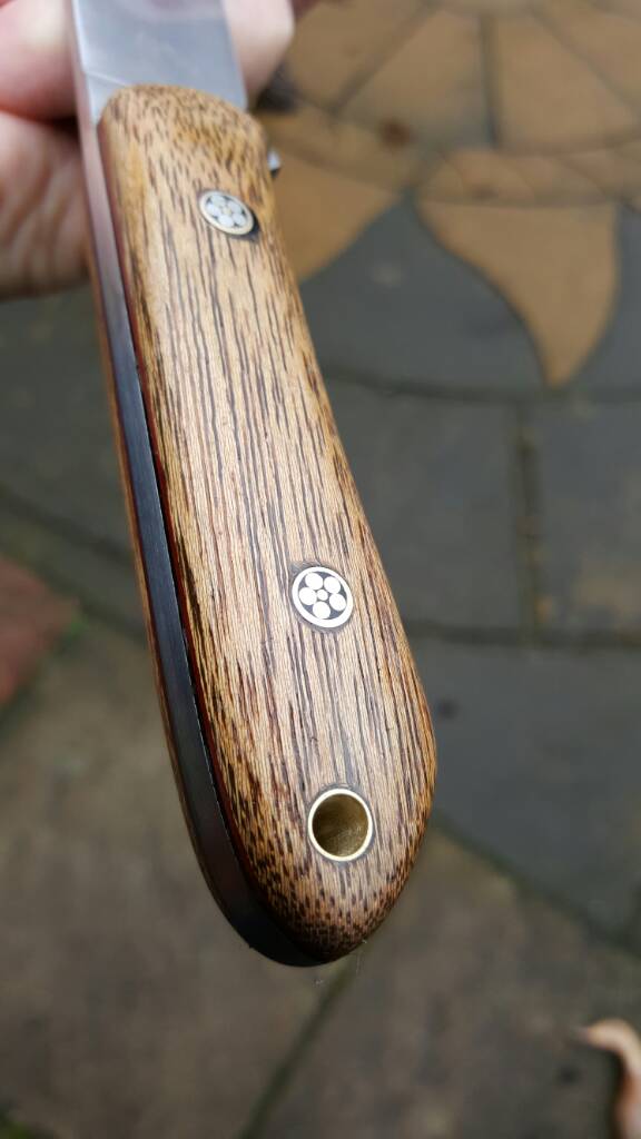

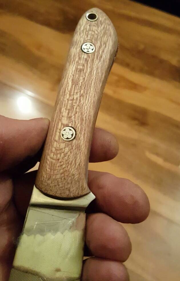

Getting there. My first ever knife with the rescued mahogany scales. Not perfect by some way but I'm happy with this first attempt. The handle needs oiling now.
Thanks for all the advice.
