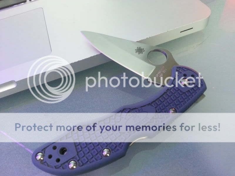

There was a sprint run of ZDP Delicas a while back. They have a saber grind with powder blue handles. But the British Racing Green full flat ground ZDP Delicas are full production.
Here's mine:
