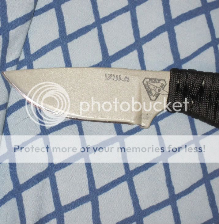

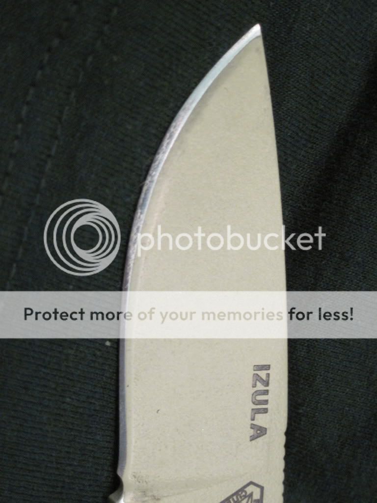

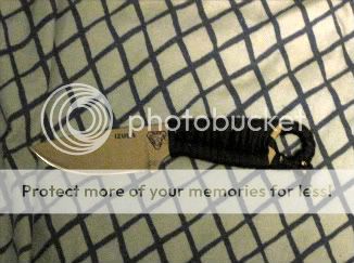

Here's the edge on my Izula
8* per side:eek:. Now we're talkin'. Whats the limit for that shallow an edge angle in terms of tasks that start to produce deformation? 10* is about as low as I've gone, and I didnt see any deformation, but it was nearly 10 points harder than the Izula.
Looks like you need less angle, it also looks like you have a little recurve to the blade along with uneven pressure. Maybe try working from the tip to the choil when sharpening.
