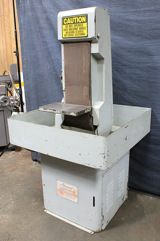

Out of knife world nobody use any kind of plate behind belts to grind metal ...no one . Industry use only wheels , wheels of different size ....
I have to call you on that statement Natlek. This is a ridiculous thing to say. Many things in industry use a platen backed belt, and many industrial grinders come with one installed.
We have already enough problems with flat platen ...
I thought on little more sophisticated belt grinders and work on real steel , not on something like this for taking burr of angle iron . . .
Maybe you have problems with a flat platen but I really like the one I am using that Nathan made. If you have platen problems maybe you should try one. Also his curved platens were 36,48,and72"
You have same problems/ ok , flaws / with flat platen as I have ...... they are wear million times faster , they generate far,far more heat then wheels , they don t grind as fast as wheels , belts last much more on wheels ........
