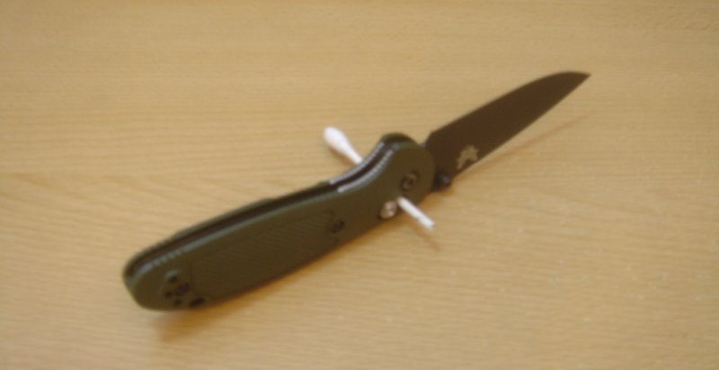

You'll need to prop the Axis lock open. Trying to align the washers and blade in there otherwise is extremely difficult. I've found using a Q-tip stem works well.
1. Re-assemble the liners w/ the Axis lock and omega springs and stop pin all in place
2. Put the back handle scale back on
3. Pull the Axis lock back (like you would to disengage the lock), and use a Q-tip stem to hold it open (see pic below). A toothpick can work too, but the thicker stem of the Q-tip pushes the Axis lock further out of the way
4. Align the pivot tube with the notch in the liner
5. Put one washer in, and nudge the pivot tube in enough to hold it in place.
6. Put the blade in (in the same position as if it were open), and then push the pivot tube through enough to hold the blade in place.
7. Slide the second washer into the gap between the blade and liner. A toothpick can be useful here to slide it around to align it with the pivot tube.
8. Put the front handle scale back on
9. Put the pivot screw back in, and remove the Q-tip
