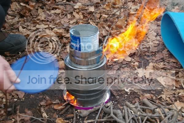

I keep this in BOB. It is mainly used with a Trangia, but it is compatible with pot candles and fuel tabs, and of course, small wood. There are two sets of three holes drilled to provide intake and exhaust, and two pairs of smaller holes that put the Trangia at it's most efficient. The bottom was cut out using a side cut can opener. I've used these for years- the only reason I've retired them is due to being squashed, rust (the one that lives in my trunk) or being gifted to someone. They are perfect for use with the spacesaver-type cups for Nalgenes- using the end cap as a cup lid, I can boil a point of water in about three minutes if I'm using denatured for fuel.
This is the full kit, at least as far as the stove goes- other things get stowed in the dead space. Trangia burner, two sets of wires so it can be used with the Trangia or other types of fuel and certain small pots, an end cap to use as a pot lid or a top "burner" plate, and two blue caps to keep everything inside. Missing from this and since added is a little bit of wire mesh, for the best efficiency with triox and esbit tabs.
This was an experimental stove I tried out awhile back. I hate my cooking cup/pot getting carboned up, so I thought I would use the bottom of the can as a stove top. The secondary ring on top was to further prevent carbon from getting on the cup (small can in the picture) and also to reduce the cooling effect of wind on the cooking container.
Overall it worked pretty well and if I do any more extended canoe trips, I'll probably take it along, but normally, I don't cook any more than I have to.

Very intresting idea. I like the comapct nature of the unit.
One thought on the overall design though. I would consider moving the "stabelizing (threaded) rods" up a little more that way there would be more space at the base to add more fuel/wood to the fire with-out haveing to take the pot/pan off of it to add more. Just my $.02
