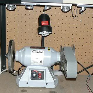

Hello cbwx34, could you explain how the laser helps you. I have not yet tried paper wheels but I am sure I will sooner or later.
I sharpen on the paper wheels at the top of the wheel, wheel turning away, holding the blade level and setting the angle by moving down the wheel. Described here: Paper Wheel Sharpening
Saw this laser level guide at Lowes for around $12. It's a Black and Decker BDL220S. Has a magnet in the base so I just stuck it on a clamp above the wheel. Made tick marks on the grinder body for certain angles. Now I just line the laser on the mark, turn the wheel on, and I have a nice guide to maintain the angle. Works especially well for unusual shaped blades. Sharpen with the blade just below the line, so it doesn't get reflected back.

That laser Idea is awesome, how hard was that to get all setup?
jayjaytuner: I have the same grinder you have and was wondering if the wider 10" wheel would fit the shaft. Did you have to do anything special to get the wheels to fit? How is the 10" wheel working out for you? Does this grinder have enough power for the 10"wheels? Thanks for the post Jeff
sampson2269: I have the same Laser and do find it useful. If you have many hours sharpening on the wheels, you probably wouldn't need the Laser anymore. For some reason my Laser is weak on the left side. Images shown here look much better than mine. Where did you get that belt sander attachment for the grinder? Great post. Thanks. Jeff
sampson2269: The laser setup was pretty easy to setup. An online calculator gave me the circumference, then I divided it to get the distance for every 10 deg. (.698" on an 8" wheel if my notes are accurate - don't trust me :) ). Then made tick marks on the wheel. So, to set the laser, I "zero" the wheel, line the laser light up on the angle I want, and sharpen. (As an afterthought, since I don't move the grinder or laser, I just made tick marks on the grinder itself, and now line up the laser using those). Easier to do than it sounds.

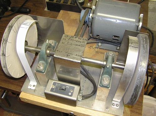

NRA,
You can see the tic marks in my post #5 this thread. I have been using the laser for over a year now. Used the tic marks to first set up the laser marks on a permanent plate. Now just aim the laser at the marks on the plate and I have the angle I want marked across the wheels when its running.
Ron
