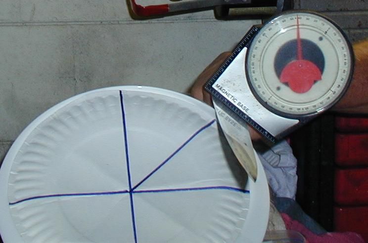

@NRA. I took this pic myself (left hand - no helper) so its not exact but Illustrates what CBWX34 said. The knife is at the 45 degree mark so the bevel will be 45 degrees. So if you split the distance towards the top and held the knife at that point of the wheel, the bevel would be 22 1/2 degrees.

Nope. In order to be accurate, as shown, the blade needs to be held horizontally,
not tangentially. The angle of the blade edge/wheel intersection shown in
the photograph is zero degrees. Can't be done unless the blade is infinitely
thin. Really sharp, but impossibly thin.
Quote "so its not exact but Illustrates what CBWX34 said". I should have looked for this pic instead of trying to be a solo photo taking magician

When you say horizontally, do you mean the flat of the blade horizontally, or the main bevel horizontally (assuming it's not a ffg)?
The flat of the blade. Actually, it would be the center of the blade
longitudinally from the center line of the spine to the center line of
the edge, but just hold the blade roughly horizontal if you use the
method shown above. Make sure the wheel is running away from you.

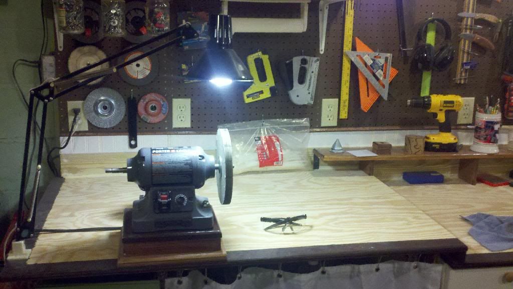

Add a bright light, a little height and just one wheel at a time made a big difference for me.
§ David §
Why did running one wheel make such a big difference? Was it just because of working space?
Alot of times I'd get too close to the other wheel and hit my arm on it. I was trying to be careful but it made my concentration to the edge move to arm.
Talking with richardj, he said use one wheel that's what I do. So now it works for me too.
