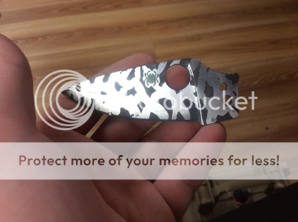

I'm gonna try to make a design on my computer, print it out, go over it with a pencil, put some invisible tape over that and pick up the pencil marks, put the tape on my knife, cut out the design with an xacto knife, paint over the tape, and then peel the tape off and put the painted blade in the acid. I've got a persistence blade in acid right now just to see how well the process is gonna work.

go for it. And dont be afraid to leave it in for a while. Just clean the heck out of the blade with alcohol and dont touch it with your fingers after. Wear rubber gloves or touch it with a rag. The oils will destroy the process.

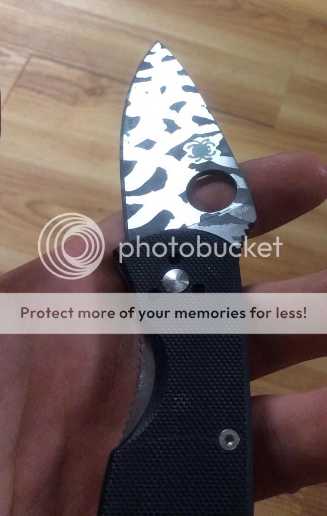

I appreciate the advice, I just pulled out the persistence blade, I think this link should work for pics
It's not exactly what I was going for, but it's not awful for my first try either. I just free handed the nail polish to see how the stuff I got would hold up to the pcb. I need to be a lot more conservative with the nail polish if I end up free handing again in the future. I'll probably end up redunking it later on. I'm gonna do the emerson as soon as I have time to polish the blade and set the designs up, I'll post more pics then.

How long did you end up leaving it in?

I left the persistence in for about 35 minutes without diluting the etchant. I plan on doing the emerson tomorrow, time allowing. Goodluck on the techno, those are awesome. :D
