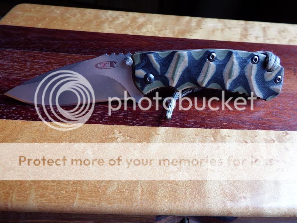

0550, cammo G-10, edge honed to 15 degs per side, Ti heat colored.

I use PCB etchant from Radio Shack. I heat a dish, deep enough to submerge the work in, in the microwave, put the piece in, and move it around once in a while for 3 or 4 min's. Not dark enough you, toss it back in a while longer. You can't go wrong, if you don't like it a little while on the buffing wheel, and you are back where you started.
Flaming. I use my little butane/propane torch, and try to heat the entire piece evenly. Play around with that too, as some time on the buffing wheel will take you back to the begining, and you can start over, and continue your learning curve.Some have warned that flaming could cause the detent ball to fall out. I guess I'm just lucky. I have flamed 5 or 6 of my Ti frame locks, and have had no problems.
The hardest part of these three mods is just committing to try them the first time.
Goold Luck, Dan.

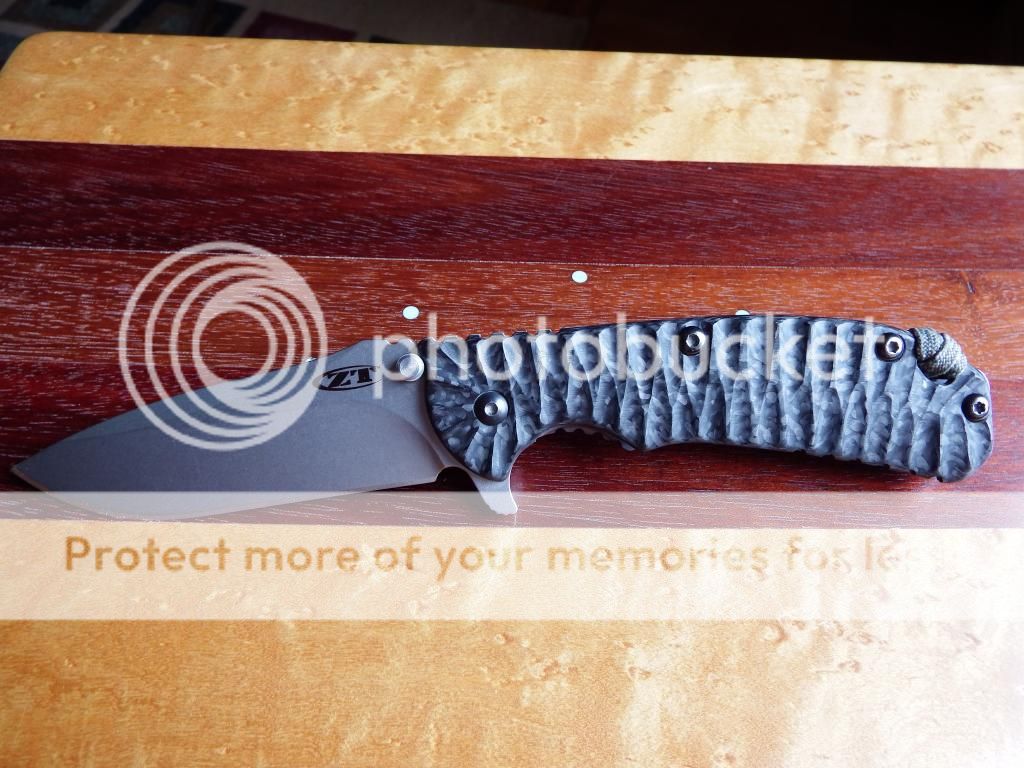

Spent a bit more time putting some final touches on my 566. I picked up a set of diamond coated files and deepened the work until I was satisfied then I used 800 and 1500 grit wet/dry to smooth out the files marks. I'm really happy with how it turned out. I'm leaving the G10 as it is. This is a work knife and I use it every day so I'm not going to try to dress it up.
That's a really cool customization I've not seen before. Nice job!
