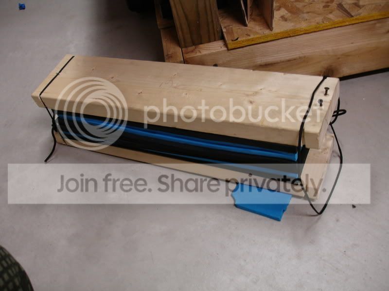

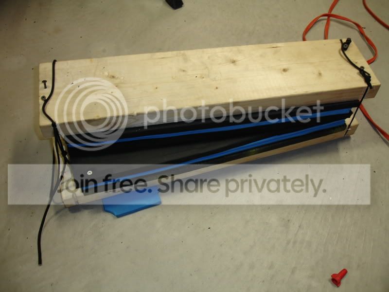

My kydex press. I stand on it and then tie it closed:

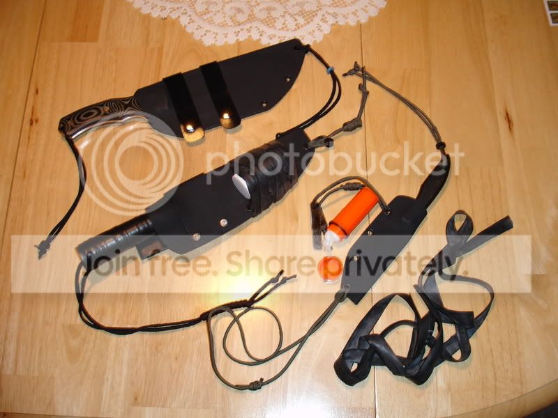

The first three sheaths that I have made:
The WSK sheath:
An the Bushman sheath that still needs tweaking:

It is fun. Time consuming for me yet, but still fun. I am still learning the kydex sheath making thing, so it takes me several tries before I have a sheath near the form I want it. And after that point, I usually need to do some fine tuning with a heat gun.
The press is made of a scrap 2x6. The black foam is some 1" foam rubber stuff i had lying around, and the blue stuff is from a closed-cell sleeping pad I picked up at Kmart for around $7. The press is held together with paracord attached to screws. Pretty simple, and it does the job.

Depending on the size of the sheath, you can use a couple of different methods to heat kydex. On a small piece your heat gun would work pretty well, or a toaster oven is a good bet. I just did a 16.5" khukri, so in addition to having to buy over sized kydex, I also need to heat in a full sized oven. In an oven you'll want to heat the kydex to around 285 degrees. Make sure you place it on a cookie sheet or something similar as, it will mold to the shape of the wire rack if you place it directly on the rack. I ruined a test piece of kydex placing it on the toasting rack in my gas grill to see if it would work in there. (I don't recommend it). You can order all the parts you might need from knifekits.com. Kydex rivets are the prefered method of joining Kydex, however I'm real happy with the results I got with standard pop-rivets. 3/16 inch "short" pop rivets work perfectly, although if I were doing it again, I'd use a rivet washer on the back for a cleaner look.

Yes, Knifekits.com for the kydex rivets and kydex. I believe I acquired my rivet flaring tool (the kind you hit with a hammer) at knifekits, as well. Occasionally one can find kydex on eBay, but desireable thicknesses are few and far between. For hardware, I also use an aluminum 'Chicago screw' thingie that I have found at a local hardware store. I used the back of the Chicago screw thingie and a pan head screw to join the belt clip for the Bushman sheath to the sheath itself through the rivets. My idea with this was to be able to facilitate a few different carry options or devices. A similar setup was used for the snaps on the WSK sheath, but with a flat head screw.
Depending on the size of the sheath/sheath component, I will either use a toaster oven, conventional oven, or a heat gun. My wife doesn't like when I use our oven in the kitchen. If I have a big piece to form, I'll wait for a day when she is out of the house.
I cut my kydex with either a set of tin snips or a compass saw.
For me, and as infrequently as I do, working with the kydex is still a trial and error thing. But as long as you don't scorch or melt the piece, you can make many attempts at forming it. If it doesn't happen the way you want it to, back into the oven or under the gun she goes for another try.
